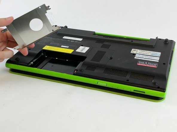

    • Importance: Removing the hard drive cover is necessary to access screws and components beneath it.
    • 1. Locate the hard drive cover on the laptop’s underside, typically secured with four Phillips-head screws. 2. Use a properly sized screwdriver to remove these screws. Keep them in a secure container to prevent loss. 3. Gently lift and remove the hard drive cover.
    • This guide's reference device lacks a hard drive, but the steps remain the same. If your laptop has a hard drive installed, carefully slide it out after the cover is removed.
  4. Sony Vaio VPCCB290X Optical Drive Replacement: crwdns2935265:04crwdnd2935265:01crwdnd2935265:01crwdne2935265:0
    • Importance: The plastic bottom panel must be removed to access internal hardware, including the optical drive.
    • Identify and unscrew all visible screws securing the bottom panel to the chassis.
    • Inspect areas near vents, ports, and hinges for hidden screws. These screws are often overlooked and can cause resistance when prying the panel off.
    • Remove screws holding the hard drive in place (if present) to facilitate panel removal.
    • Arrange screws in a pattern matching their original location to avoid confusion during reassembly.

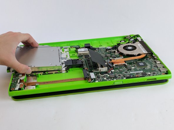

    • This is the final step to replace the faulty drive with a new one.
    • Locate the screws securing the optical drive to the laptop chassis. These screws are typically positioned near the drive bay, accessible once the bottom panel is removed.
    • Unscrew these screws with a Phillips-head screwdriver. Set the screws aside in a safe container.
    • Gently push or pull the optical drive to slide it out of the bay. Use even pressure to avoid damaging the drive or surrounding components.
    • If the drive feels stuck, ensure that all securing screws have been removed and check for potential obstructions within the bay.
