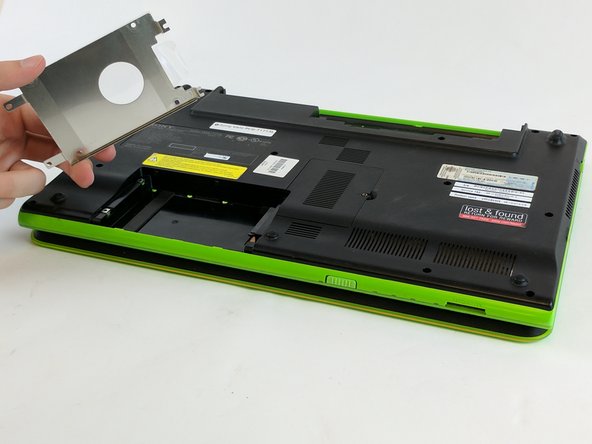

  3. Sony Vaio VPCCB290X LCD Screen Replacement: crwdns2935265:03crwdnd2935265:01crwdnd2935265:02crwdne2935265:0 Sony Vaio VPCCB290X LCD Screen Replacement: crwdns2935265:03crwdnd2935265:02crwdnd2935265:02crwdne2935265:0
    • Remove the screws marked in red to remove the hard drive cover and the screws marked in blue to loosen the hard drive. Then gently slide the hard drive out.

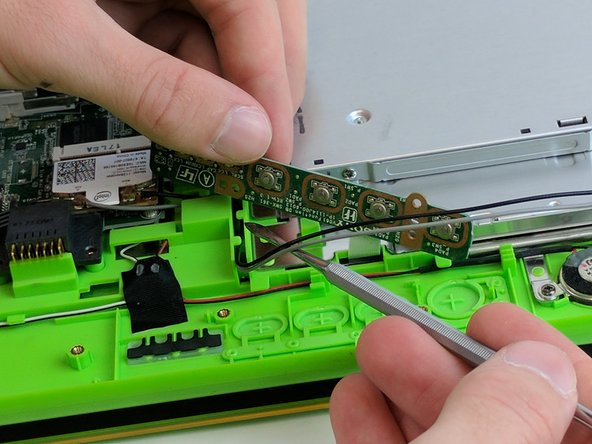

  8. Sony Vaio VPCCB290X LCD Screen Replacement: crwdns2935265:08crwdnd2935265:01crwdnd2935265:02crwdne2935265:0 Sony Vaio VPCCB290X LCD Screen Replacement: crwdns2935265:08crwdnd2935265:02crwdnd2935265:02crwdne2935265:0
    • You will need to unscrew this small circuit board and fold it up to get the wires out from under it.
