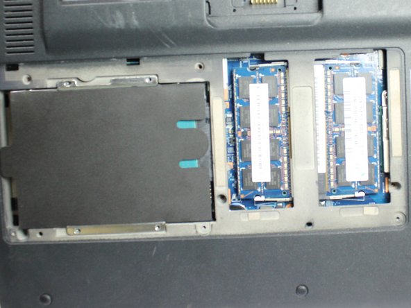

    1. Sony Vaio VPC-Y2190X RAM Card Replacement, RAM Card: crwdns2935265:04crwdnd2935265:01crwdnd2935265:02crwdne2935265:0 Sony Vaio VPC-Y2190X RAM Card Replacement, RAM Card: crwdns2935265:04crwdnd2935265:02crwdnd2935265:02crwdne2935265:0
      • Use a #0PH screwdriver to unscrew the three 4.80mm screws.
      • Remove the panel.
    2. Sony Vaio VPC-Y2190X RAM Card Replacement: crwdns2935265:05crwdnd2935265:01crwdnd2935265:01crwdne2935265:0
      • Pull the metal tabs in opposite directions, away from the RAM card.
      • The RAM card will swing upwards.
    3. Sony Vaio VPC-Y2190X RAM Card Replacement: crwdns2935265:06crwdnd2935265:01crwdnd2935265:01crwdne2935265:0
      • Grab the RAM card from its center.
      • Gently pull the RAM card out.
