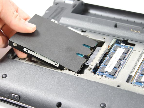

    • Carefully lift the hard drive.
    • Remove the hard drive by pulling it to the left.

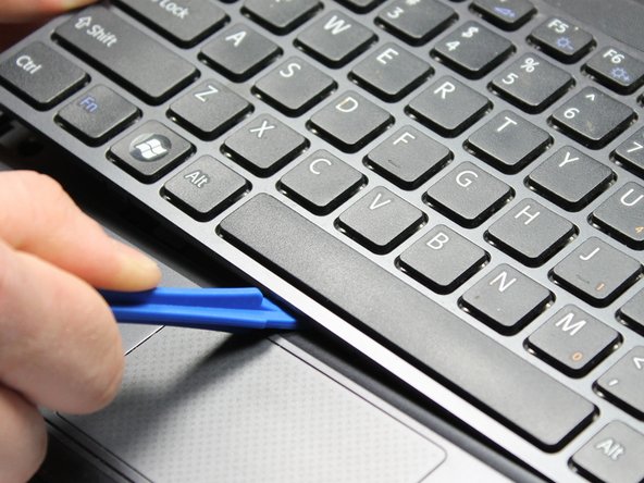

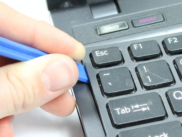

    • Flip your Vaio so that the keyboard is facing up.
    • Use the iFixit Opening Tool to lift the keyboard from the frame, starting at the ESC key corner.
    • Gently slide the iFixit Opening Tool along the edge of the keyboard.
    • The keyboard is connected to the frame with a wire, do not fully lift the keyboard from the frame

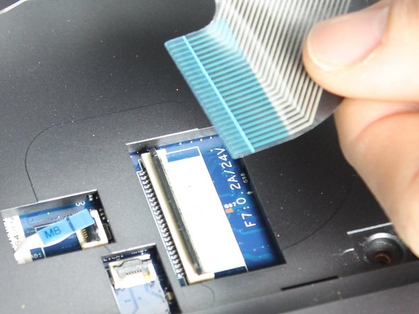

    • The cable is located under the keyboard, just above the touchpad.
    • Use the iFixit Opening Tool to flip the clip up in order to release the cable.
    • Detach the cable from the frame.
    • Remove the keyboard from the frame.

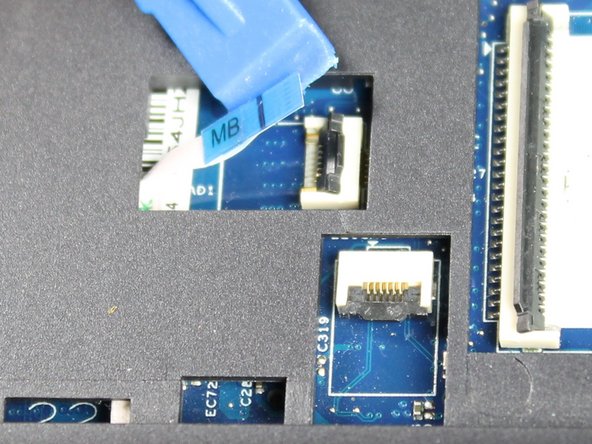

  10. Sony Vaio VPC-Y2190X Motherboard Replacement: crwdns2935265:010crwdnd2935265:01crwdnd2935265:03crwdne2935265:0 Sony Vaio VPC-Y2190X Motherboard Replacement: crwdns2935265:010crwdnd2935265:02crwdnd2935265:03crwdne2935265:0 Sony Vaio VPC-Y2190X Motherboard Replacement: crwdns2935265:010crwdnd2935265:03crwdnd2935265:03crwdne2935265:0
    • Use the iFixit Opening Tool to lift the edge of the clip from the cable.
    • Gently pull the cable away from the clip.
    • Repeat the first two steps on the second clip shown in the picture.

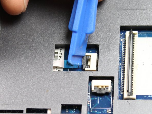

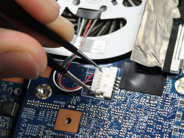

  11. Sony Vaio VPC-Y2190X Motherboard Replacement: crwdns2935265:011crwdnd2935265:01crwdnd2935265:02crwdne2935265:0 Sony Vaio VPC-Y2190X Motherboard Replacement: crwdns2935265:011crwdnd2935265:02crwdnd2935265:02crwdne2935265:0

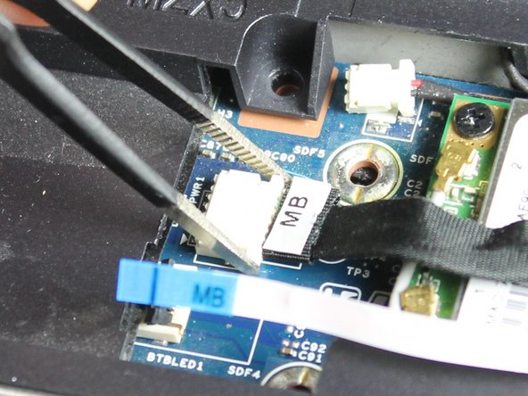

    • Use the iFixit Opening Tool to detach the cable from the motherboard.
    • Use the small needle nose pliers to pull the cable from the motherboard.
  12. Sony Vaio VPC-Y2190X Motherboard Replacement: crwdns2935265:012crwdnd2935265:01crwdnd2935265:03crwdne2935265:0 Sony Vaio VPC-Y2190X Motherboard Replacement: crwdns2935265:012crwdnd2935265:02crwdnd2935265:03crwdne2935265:0 Sony Vaio VPC-Y2190X Motherboard Replacement: crwdns2935265:012crwdnd2935265:03crwdnd2935265:03crwdne2935265:0

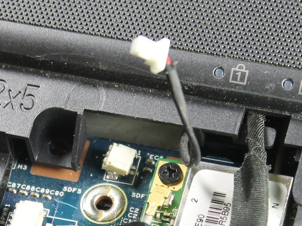

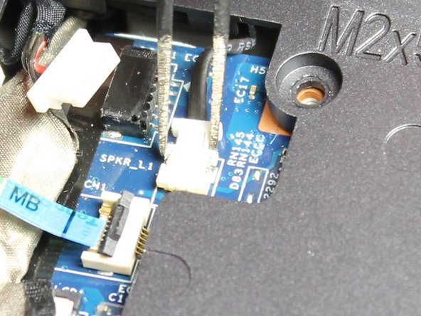

    • Use the iFixit Opening Tool to flip the clip up in order to release the first cable.
    • Use the small needle nose pliers to pull the second cable from where it is attached.
    • Use the small needle nose pliers to detach the third cable from motherboard.

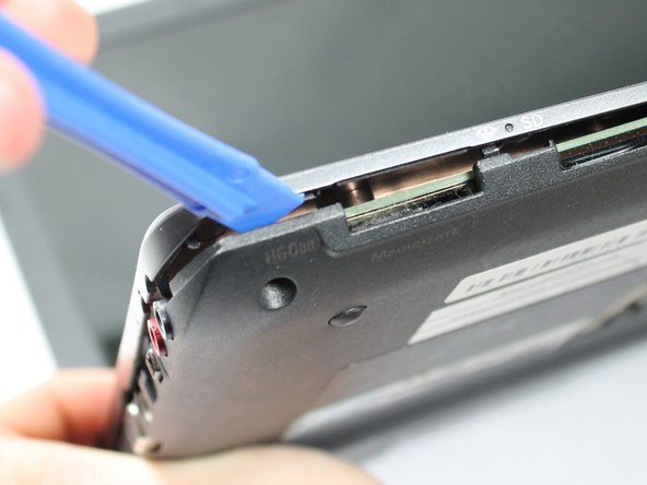

  13. Sony Vaio VPC-Y2190X Motherboard Replacement: crwdns2935265:013crwdnd2935265:01crwdnd2935265:02crwdne2935265:0 Sony Vaio VPC-Y2190X Motherboard Replacement: crwdns2935265:013crwdnd2935265:02crwdnd2935265:02crwdne2935265:0
    • Use the iFixit Opening Tool to lift the back of the Vaio from the frame.
    • Slide the iFixit Opening Tool around the edges of the frame.

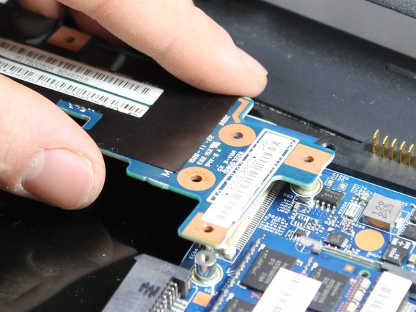

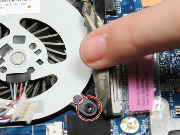

    • Use the small needle nose pliers to pull the cable connector from the motherboard.
    • Push the flap to the side so you can access the screw beneath.
    • Use the #0PH screwdriver on the one 5.63mm screw.
  15. Sony Vaio VPC-Y2190X Motherboard Replacement: crwdns2935265:015crwdnd2935265:01crwdnd2935265:01crwdne2935265:0
    • Unscrew the 5.63mm screw tethering the motherboard to the laptop with a #0PH screwdriver.
    • Remove the piece from the motherboard.

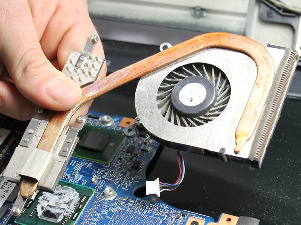

    • Use a #0PH screwdriver to remove the three 3.61mm screws holding the fan to the motherboard.
    • Remove the fan from the motherboard.

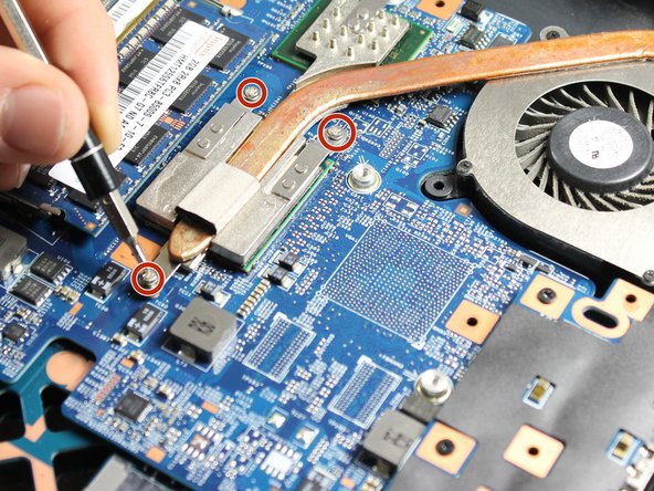

  17. Sony Vaio VPC-Y2190X Motherboard Replacement, Motherboard: crwdns2935265:017crwdnd2935265:01crwdnd2935265:02crwdne2935265:0 Sony Vaio VPC-Y2190X Motherboard Replacement, Motherboard: crwdns2935265:017crwdnd2935265:02crwdnd2935265:02crwdne2935265:0
    • Remove the three 5.63mm screws using the 0PH screwdriver.
    • Remove the motherboard.
