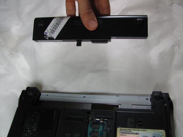

    • Flip the computer so that the bottom is facing up.
    • Look to the long edge where the computer screen is hinged and find the "release slide". It is located at the top left corner of the square indent.
  2. Sony Vaio VGN-TXN25N Hard Disk Drive Replacement: crwdns2935265:02crwdnd2935265:01crwdnd2935265:01crwdne2935265:0
    • Use your finger to slide the release to the left.
  3. Sony Vaio VGN-TXN25N Hard Disk Drive Replacement: crwdns2935265:03crwdnd2935265:01crwdnd2935265:02crwdne2935265:0 Sony Vaio VGN-TXN25N Hard Disk Drive Replacement: crwdns2935265:03crwdnd2935265:02crwdnd2935265:02crwdne2935265:0
    • While holding the release slide with one hand, use your opposite hand to pull the battery from its slot by gently shaking the battery left and right to help slide it out.

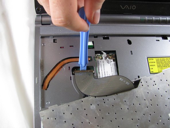

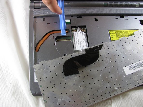

  7. Sony Vaio VGN-TXN25N Hard Disk Drive Replacement: crwdns2935265:07crwdnd2935265:01crwdnd2935265:02crwdne2935265:0 Sony Vaio VGN-TXN25N Hard Disk Drive Replacement: crwdns2935265:07crwdnd2935265:02crwdnd2935265:02crwdne2935265:0
    • Do not pull the keyboard away from the computer. There is a ribbon cord attaching the keyboard to the computer.
    • Once the keyboard has been lifted at a few edges, lift the keyboard with both hands.
  8. Sony Vaio VGN-TXN25N Hard Disk Drive Replacement: crwdns2935265:08crwdnd2935265:01crwdnd2935265:03crwdne2935265:0 Sony Vaio VGN-TXN25N Hard Disk Drive Replacement: crwdns2935265:08crwdnd2935265:02crwdnd2935265:03crwdne2935265:0 Sony Vaio VGN-TXN25N Hard Disk Drive Replacement: crwdns2935265:08crwdnd2935265:03crwdnd2935265:03crwdne2935265:0
    • Locate the ribbon cord behind the keyboard.
    • Locate a brown clamp attaching the keyboard to the computer.
    • Use a plastic opening tool to lift the clamp and release the cable.
    • Now the keyboard can be pulled away entirely.
