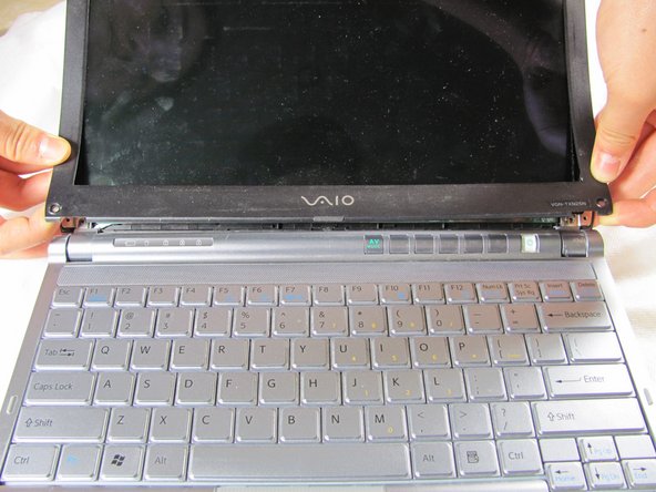

    • Place the computer on a flat surface with the top facing up.
    • Open the screen.

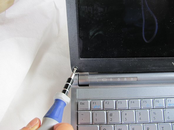

  3. Sony Vaio VGN-TXN25N Display Screen Replacement: crwdns2935265:03crwdnd2935265:01crwdnd2935265:02crwdne2935265:0 Sony Vaio VGN-TXN25N Display Screen Replacement: crwdns2935265:03crwdnd2935265:02crwdnd2935265:02crwdne2935265:0
    • Locate the two screws, one on each bottom corner.
    • Unscrew the screws with a Phillips head size #0 screwdriver.
    • Keep track of the screws. They are small and easy to misplace.
  4. Sony Vaio VGN-TXN25N Display Screen Replacement: crwdns2935265:04crwdnd2935265:01crwdnd2935265:03crwdne2935265:0 Sony Vaio VGN-TXN25N Display Screen Replacement: crwdns2935265:04crwdnd2935265:02crwdnd2935265:03crwdne2935265:0 Sony Vaio VGN-TXN25N Display Screen Replacement: crwdns2935265:04crwdnd2935265:03crwdnd2935265:03crwdne2935265:0
    • Use a plastic opening tool to gently lift the plastic casing that borders the screen.
    • Pop off the casing by working the tool around the outside of it.
    • Wiggling the tool may be required. The casing could be fitted snugly.

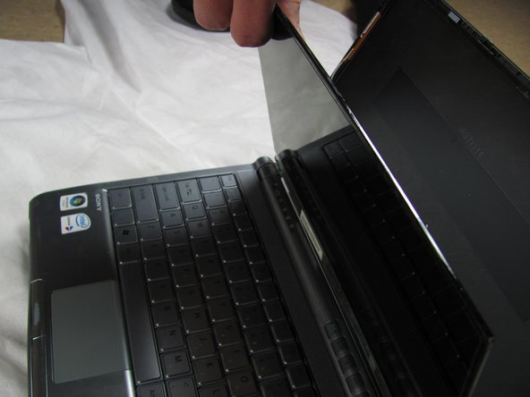

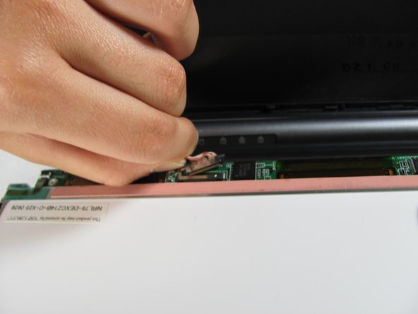

  5. Sony Vaio VGN-TXN25N Display Screen Replacement: crwdns2935265:05crwdnd2935265:01crwdnd2935265:03crwdne2935265:0 Sony Vaio VGN-TXN25N Display Screen Replacement: crwdns2935265:05crwdnd2935265:02crwdnd2935265:03crwdne2935265:0 Sony Vaio VGN-TXN25N Display Screen Replacement: crwdns2935265:05crwdnd2935265:03crwdnd2935265:03crwdne2935265:0
    • Carefully flip down the screen so it rests on the keyboard.
    • Locate the wire connector on the back of the screen and use a plastic opening tool to gently loosen the wire connection.
  6. Sony Vaio VGN-TXN25N Display Screen Replacement: crwdns2935265:06crwdnd2935265:01crwdnd2935265:01crwdne2935265:0
    • Remove the screen.
