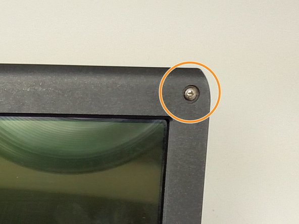

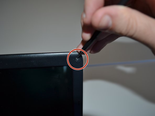

    • Remove the rubber pads at all four corners of the screen bezel using a spudger. This will reveal four 5mm Phillips screws.
    • Use a Phillips #1 screwdriver to remove the four screws and set them aside.

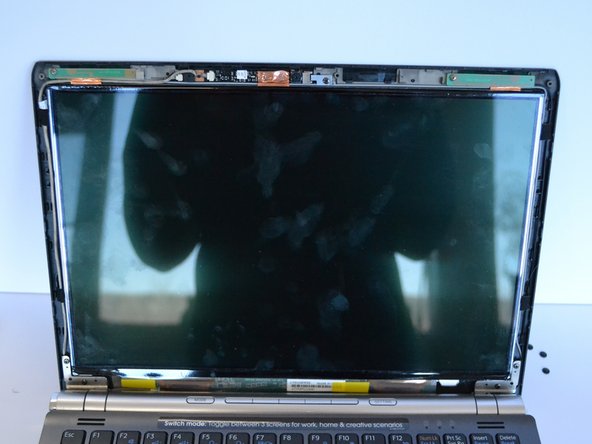

    • Remove the screen's plastic bezel. You may need to use slight pressure to release the clips that secure the bezel to the laptop.
  6. Sony Vaio VGN-SR140E Screen Replacement: crwdns2935265:06crwdnd2935265:01crwdnd2935265:02crwdne2935265:0 Sony Vaio VGN-SR140E Screen Replacement: crwdns2935265:06crwdnd2935265:02crwdnd2935265:02crwdne2935265:0
    • Lift screen bezel up and off of the laptop.
  7. Sony Vaio VGN-SR140E Screen Replacement: crwdns2935265:07crwdnd2935265:01crwdnd2935265:03crwdne2935265:0 Sony Vaio VGN-SR140E Screen Replacement: crwdns2935265:07crwdnd2935265:02crwdnd2935265:03crwdne2935265:0 Sony Vaio VGN-SR140E Screen Replacement: crwdns2935265:07crwdnd2935265:03crwdnd2935265:03crwdne2935265:0

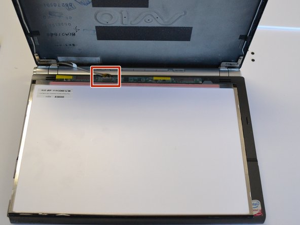

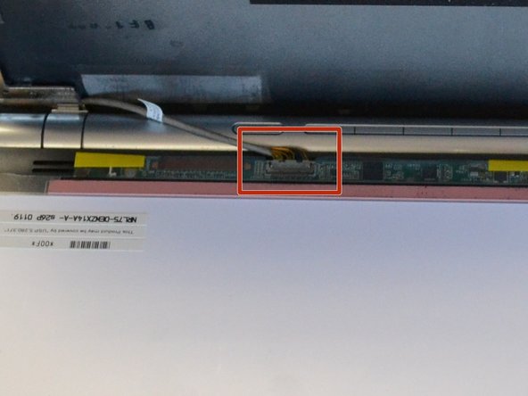

    • Close the laptop carefully and slowly while holding the screen with your thumb to prevent it from falling.
    • Lay the screen gently on the keyboard. This will reveal the screen's connector.

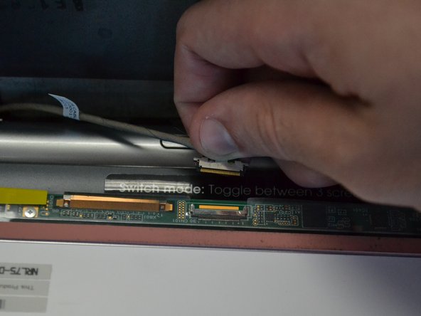

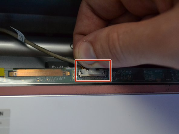

  8. Sony Vaio VGN-SR140E Screen Replacement: crwdns2935265:08crwdnd2935265:01crwdnd2935265:03crwdne2935265:0 Sony Vaio VGN-SR140E Screen Replacement: crwdns2935265:08crwdnd2935265:02crwdnd2935265:03crwdne2935265:0 Sony Vaio VGN-SR140E Screen Replacement: crwdns2935265:08crwdnd2935265:03crwdnd2935265:03crwdne2935265:0
    • Grasp the connector and gently pull it out.
  9. Sony Vaio VGN-SR140E Screen Replacement: crwdns2935265:09crwdnd2935265:01crwdnd2935265:01crwdne2935265:0
    • The screen can now be removed.
