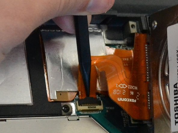

  7. Sony Vaio VGN-SR140E Hard Drive Replacement: crwdns2935265:07crwdnd2935265:01crwdnd2935265:02crwdne2935265:0 Sony Vaio VGN-SR140E Hard Drive Replacement: crwdns2935265:07crwdnd2935265:02crwdnd2935265:02crwdne2935265:0
    • Use the spudger or a fingernail to carefully release the lock securing the ribbon cable to the motherboard.

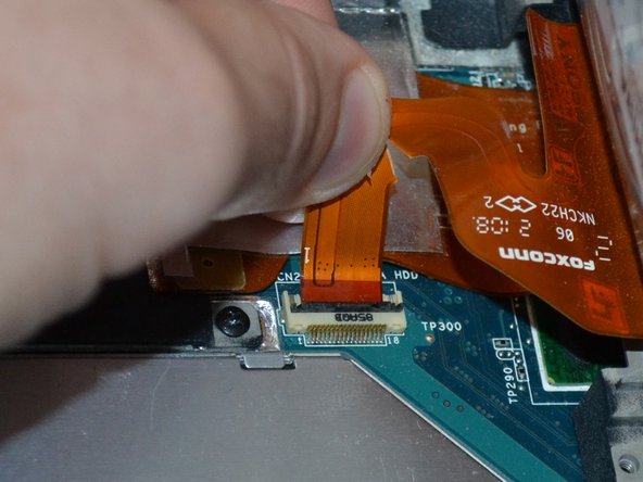

  8. Sony Vaio VGN-SR140E Hard Drive Replacement: crwdns2935265:08crwdnd2935265:01crwdnd2935265:02crwdne2935265:0 Sony Vaio VGN-SR140E Hard Drive Replacement: crwdns2935265:08crwdnd2935265:02crwdnd2935265:02crwdne2935265:0
    • Grasp the ribbon cable carefully near the connector end. Remove it by pulling the cable away from the connector on the motherboard at a slightly upward angle.
