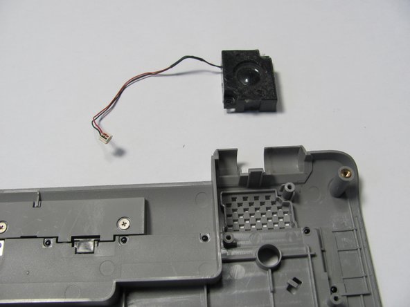

  12. Sony Vaio VGN-S260 Speakers Replacement, Speakers: crwdns2935265:012crwdnd2935265:01crwdnd2935265:01crwdne2935265:0
    • After removing the Uppercasing, flip it over and locate the two black speakers
  13. Sony Vaio VGN-S260 Speakers Replacement: crwdns2935265:013crwdnd2935265:01crwdnd2935265:02crwdne2935265:0 Sony Vaio VGN-S260 Speakers Replacement: crwdns2935265:013crwdnd2935265:02crwdnd2935265:02crwdne2935265:0
    • Remove the screws on the speakers
    • Each speaker will have two screws
    • Remove the speakers
