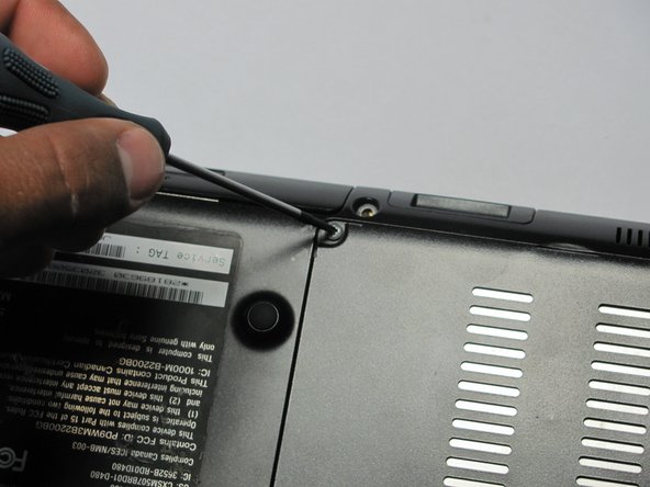

    • With the laptop still flipped over with the Vaio logo facedown, locate the screws for the RAM
    • Remove the screws

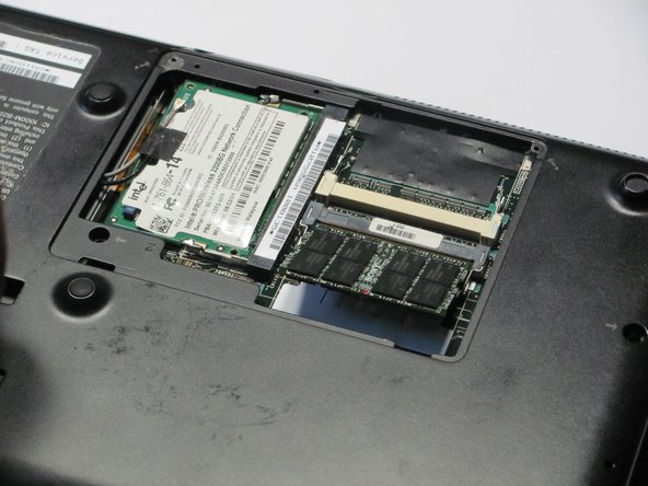

    • Lift off the unscrewed cover
    • Locate the RAM

    • Locate tabs next to RAM
    • Pull the 2 tabs away from the RAM
    • The RAM should pop up.

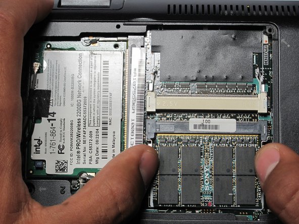

  6. Sony Vaio VGN-S260 RAM Replacement: crwdns2935265:06crwdnd2935265:01crwdnd2935265:01crwdne2935265:0
    • Gently slide the RAM up and out
