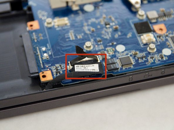

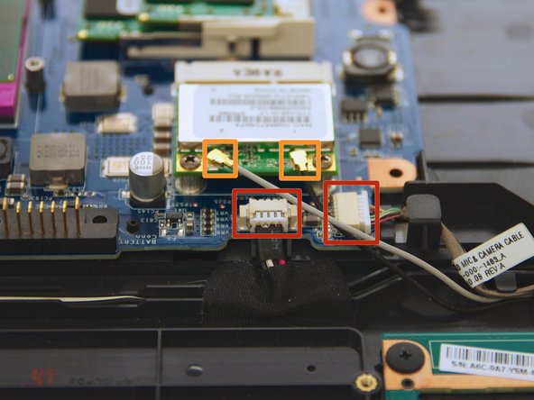

  13. Sony Vaio VGN-NW240F (PCG-7184L) Motherboard Replacement: crwdns2935265:013crwdnd2935265:01crwdnd2935265:03crwdne2935265:0 Sony Vaio VGN-NW240F (PCG-7184L) Motherboard Replacement: crwdns2935265:013crwdnd2935265:02crwdnd2935265:03crwdne2935265:0 Sony Vaio VGN-NW240F (PCG-7184L) Motherboard Replacement: crwdns2935265:013crwdnd2935265:03crwdnd2935265:03crwdne2935265:0
    • Detach all of the highlighted connectors.
    • If the connector has a plastic cable, use it to assist in removal.
    • Detach the black and grey network card cables.

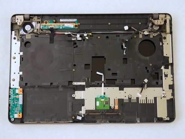

  14. Sony Vaio VGN-NW240F (PCG-7184L) Motherboard Replacement: crwdns2935265:014crwdnd2935265:01crwdnd2935265:02crwdne2935265:0 Sony Vaio VGN-NW240F (PCG-7184L) Motherboard Replacement: crwdns2935265:014crwdnd2935265:02crwdnd2935265:02crwdne2935265:0
    • Carefully lift up the motherboard from its place.
    • The USB input/output area sits within the back plate of the laptop. To ensure safe removal, lift up and pull away from the USB input panel.
    • If the motherboard does lift up or come out easily, do not apply any additional force. Check again for any unattached cables or connects before attempting again.
