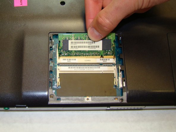

  6. Sony Vaio VGN-FS640 RAM Replacement, RAM: crwdns2935265:06crwdnd2935265:01crwdnd2935265:03crwdne2935265:0 Sony Vaio VGN-FS640 RAM Replacement, RAM: crwdns2935265:06crwdnd2935265:02crwdnd2935265:03crwdne2935265:0 Sony Vaio VGN-FS640 RAM Replacement, RAM: crwdns2935265:06crwdnd2935265:03crwdnd2935265:03crwdne2935265:0
    • To remove the RAM, use sharp end of a spudger to push the two silver tabs (see picture) away from the green RAM chip.
    • When both silver tabs are moved to the side, one edge of the RAM chip will pop up from its original position.
    • Use your fingers to grab the raised edge of the RAM and pull the chip away from its connection to the laptop.

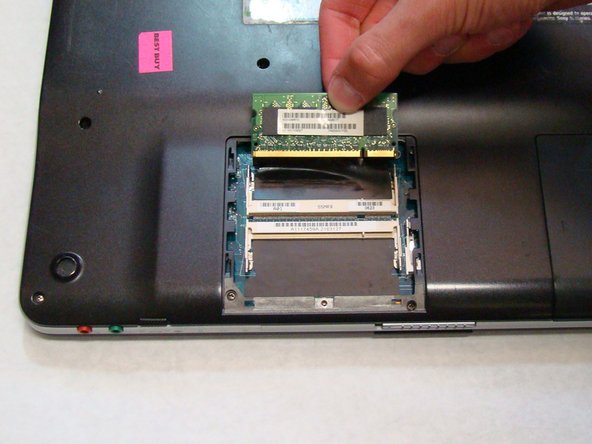

  7. Sony Vaio VGN-FS640 RAM Replacement: crwdns2935265:07crwdnd2935265:01crwdnd2935265:01crwdne2935265:0
    • To install the new RAM, grip the new chip exactly the same way as you gripped the old chip when you removed it.
    • Insert the gold leads of the RAM into the connection at the same angle the original chip was raised at after the tabs were released.
    • There is a raised tab on the connection that mates with a slit in the RAM to ensure you do not put the chip in upside down.
