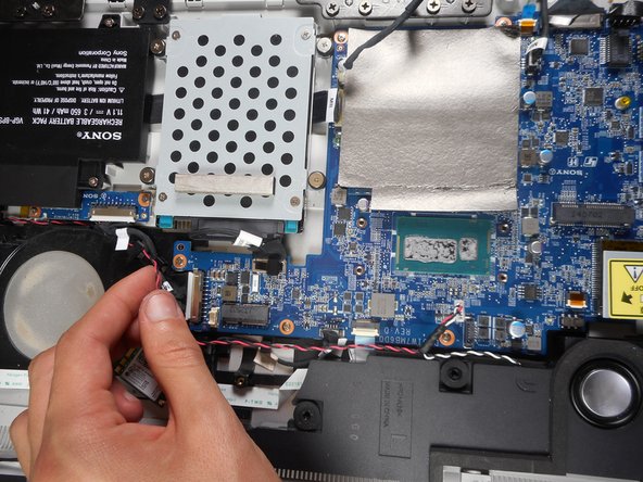

  9. Sony Vaio Tap 21 SVT212A11L Speaker Assembly Replacement: crwdns2935265:09crwdnd2935265:01crwdnd2935265:01crwdne2935265:0
    • Un-click the cables attached to the face of the motherboard.
    • These cables are secured tight in their place so remove them with a firm grip.

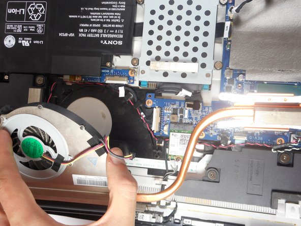

  10. Sony Vaio Tap 21 SVT212A11L Speaker Assembly Replacement: crwdns2935265:010crwdnd2935265:01crwdnd2935265:02crwdne2935265:0 Sony Vaio Tap 21 SVT212A11L Speaker Assembly Replacement: crwdns2935265:010crwdnd2935265:02crwdnd2935265:02crwdne2935265:0
    • Firmly lift the fan from the surface.
    • The fan is held tight in its place so lift it with slightly more force.

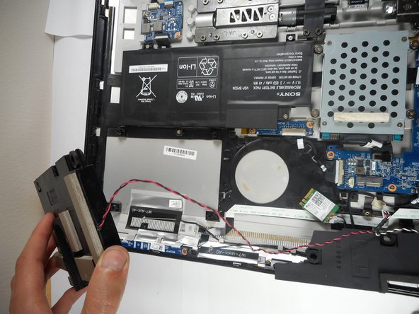

  11. Sony Vaio Tap 21 SVT212A11L Speaker Assembly Replacement, Speaker Assembly: crwdns2935265:011crwdnd2935265:01crwdnd2935265:01crwdne2935265:0
    • Use a JIS 00 screwdriver to remove a 5mm screw from the wireless receiver.
    • The wireless receiver is a chip located in the area between the motherboard, fan, and one of the speakers.

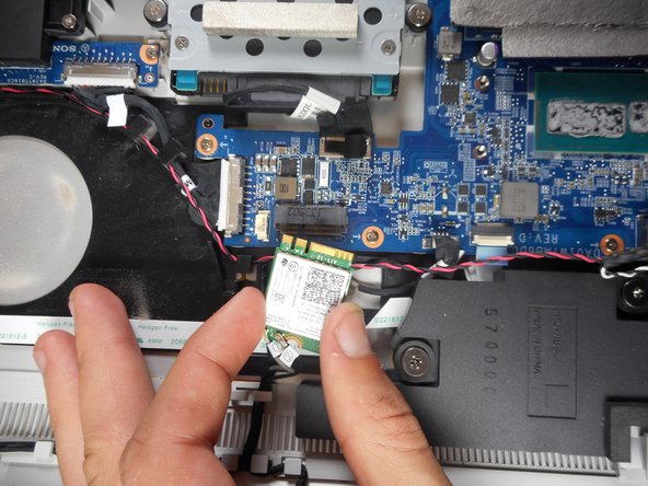

  12. Sony Vaio Tap 21 SVT212A11L Speaker Assembly Replacement: crwdns2935265:012crwdnd2935265:01crwdnd2935265:02crwdne2935265:0 Sony Vaio Tap 21 SVT212A11L Speaker Assembly Replacement: crwdns2935265:012crwdnd2935265:02crwdnd2935265:02crwdne2935265:0
    • Gently detach the wireless receiver and place it somewhere it does not obstruct the speaker assembly.
  13. Sony Vaio Tap 21 SVT212A11L Speaker Assembly Replacement: crwdns2935265:013crwdnd2935265:01crwdnd2935265:01crwdne2935265:0
    • Remove a total of four 8mm screws with the Phillips #2 screwdriver from the speaker located below the motherboard.

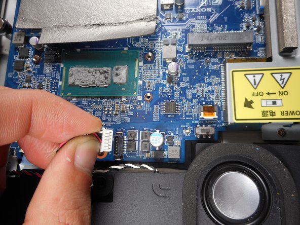

  14. Sony Vaio Tap 21 SVT212A11L Speaker Assembly Replacement: crwdns2935265:014crwdnd2935265:01crwdnd2935265:03crwdne2935265:0 Sony Vaio Tap 21 SVT212A11L Speaker Assembly Replacement: crwdns2935265:014crwdnd2935265:02crwdnd2935265:03crwdne2935265:0 Sony Vaio Tap 21 SVT212A11L Speaker Assembly Replacement: crwdns2935265:014crwdnd2935265:03crwdnd2935265:03crwdne2935265:0
    • Detach the cables that connect from the speaker to the motherboard.
    • The cables attached to the motherboard are held firmly in place so pull them with slightly more force to release them.
  15. Sony Vaio Tap 21 SVT212A11L Speaker Assembly Replacement: crwdns2935265:015crwdnd2935265:01crwdnd2935265:02crwdne2935265:0 Sony Vaio Tap 21 SVT212A11L Speaker Assembly Replacement: crwdns2935265:015crwdnd2935265:02crwdnd2935265:02crwdne2935265:0
    • Slowly lift the speaker from its base.

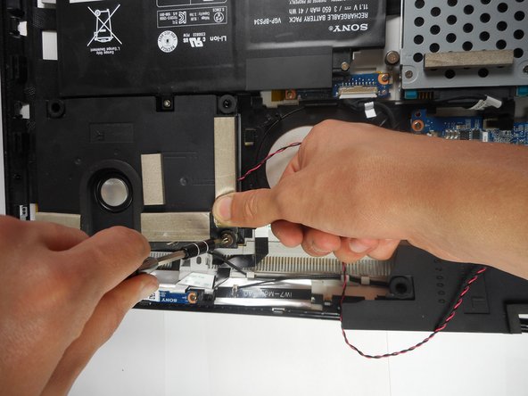

  16. Sony Vaio Tap 21 SVT212A11L Speaker Assembly Replacement: crwdns2935265:016crwdnd2935265:01crwdnd2935265:02crwdne2935265:0 Sony Vaio Tap 21 SVT212A11L Speaker Assembly Replacement: crwdns2935265:016crwdnd2935265:02crwdnd2935265:02crwdne2935265:0
    • Remove four 8mm screws from the speaker below the battery with a Phillips #2 screwdriver.
    • One of the four screws is located under a foam pad on one of the corners of the speaker. Lift the foam pad to remove the screw.

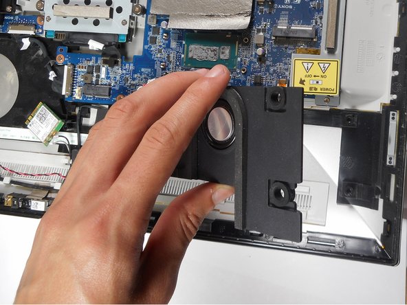

  17. Sony Vaio Tap 21 SVT212A11L Speaker Assembly Replacement: crwdns2935265:017crwdnd2935265:01crwdnd2935265:02crwdne2935265:0 Sony Vaio Tap 21 SVT212A11L Speaker Assembly Replacement: crwdns2935265:017crwdnd2935265:02crwdnd2935265:02crwdne2935265:0
    • Carefully lift the speaker from its base.
    • To fully remove the speaker assembly, remove the red and black intertwined cables that connect both speakers.
