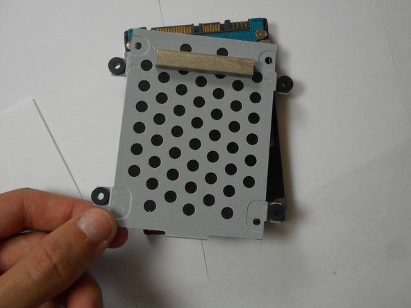

    • Locate the hard drive.
  2. Sony Vaio Tap 21 SVT212A11L Hard Drive Replacement: crwdns2935265:02crwdnd2935265:01crwdnd2935265:02crwdne2935265:0 Sony Vaio Tap 21 SVT212A11L Hard Drive Replacement: crwdns2935265:02crwdnd2935265:02crwdnd2935265:02crwdne2935265:0
    • Locate the 13mm screws for the hard drive and use the JIS 0 screwdriver to unscrew.
  3. Sony Vaio Tap 21 SVT212A11L Hard Drive Replacement: crwdns2935265:03crwdnd2935265:01crwdnd2935265:03crwdne2935265:0 Sony Vaio Tap 21 SVT212A11L Hard Drive Replacement: crwdns2935265:03crwdnd2935265:02crwdnd2935265:03crwdne2935265:0 Sony Vaio Tap 21 SVT212A11L Hard Drive Replacement: crwdns2935265:03crwdnd2935265:03crwdnd2935265:03crwdne2935265:0
    • Gently lift the hard drive upwards.
    • Ensure you have a gentle hold on the hard drive cable.
    • Gently pull the cable from the base where the cable header meets the hard drive.
    • To ensure no damage is done on the cable header, pull the header gently from both sides at the same time or gently from the center.
  4. Sony Vaio Tap 21 SVT212A11L Hard Drive Replacement: crwdns2935265:04crwdnd2935265:01crwdnd2935265:02crwdne2935265:0 Sony Vaio Tap 21 SVT212A11L Hard Drive Replacement: crwdns2935265:04crwdnd2935265:02crwdnd2935265:02crwdne2935265:0
    • Locate the screws.
    • Using the JIS 0 screwdriver, unscrew the 4mm screws.
    • Gently lift the frame after screws have been taken out.
