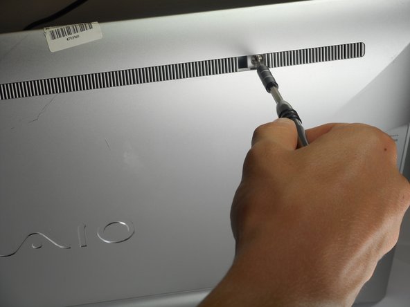

    • Insert the plastic opening tool at an angle into the grill and lift the tab by applying force down and to the left as you are lifting it out of place.
    • Use your plastic opening tool to remove the right plastic tab blocking the screw mounts behind the device.
    • The plastic tab is located on a plastic stretch of grill running along the upper half of the back of the device.
    • You can find the tab looking for a solid fill within the grill. The tab is solid within the slits.

    • Remove the two 5mm screws on the back of the device using a JIS 0 screwdriver.

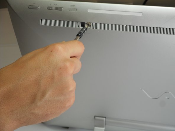

    • Face the screen of the device upwards.
    • Gently un-clip the screen around the four sides of the body with the plastic opening tool.
    • Use an up-down motion.
    • It would be easier to do this if the device is fully rested flat by pushing the device down. It should rest on the stand.

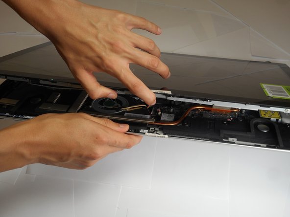

  5. Sony Vaio Tap 21 SVT212A11L Battery Replacement: crwdns2935265:05crwdnd2935265:01crwdnd2935265:03crwdne2935265:0 Sony Vaio Tap 21 SVT212A11L Battery Replacement: crwdns2935265:05crwdnd2935265:02crwdnd2935265:03crwdne2935265:0 Sony Vaio Tap 21 SVT212A11L Battery Replacement: crwdns2935265:05crwdnd2935265:03crwdnd2935265:03crwdne2935265:0
    • Lift the screen gently from the top of the device.
    • Make sure to lift the screen from the same side the screws were removed.
  6. Sony Vaio Tap 21 SVT212A11L Battery Replacement: crwdns2935265:06crwdnd2935265:01crwdnd2935265:01crwdne2935265:0
    • Slowly and gently lay the screen on its face.
    • It's important that the cables are not damaged while doing this process. Ensure as you lay the screen on its face any cables are carefully moved insuring no stress is applied on the cables.

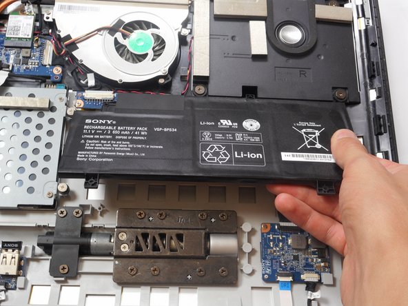

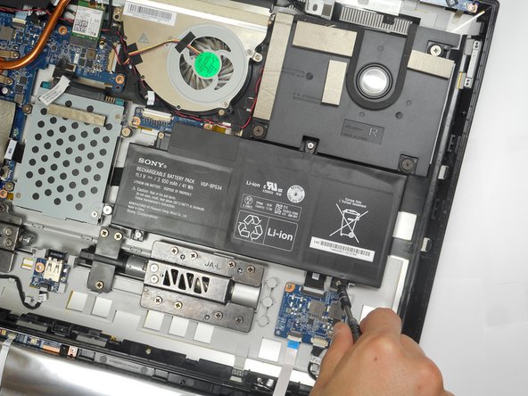

  7. Sony Vaio Tap 21 SVT212A11L Battery Replacement, Battery: crwdns2935265:07crwdnd2935265:01crwdnd2935265:02crwdne2935265:0 Sony Vaio Tap 21 SVT212A11L Battery Replacement, Battery: crwdns2935265:07crwdnd2935265:02crwdnd2935265:02crwdne2935265:0
    • Remove a total of four 10mm screws around the battery using a JIS 0 screwdriver.
  8. Sony Vaio Tap 21 SVT212A11L Battery Replacement: crwdns2935265:08crwdnd2935265:01crwdnd2935265:02crwdne2935265:0 Sony Vaio Tap 21 SVT212A11L Battery Replacement: crwdns2935265:08crwdnd2935265:02crwdnd2935265:02crwdne2935265:0
    • Gently remove the battery by lifting from the bottom up.
