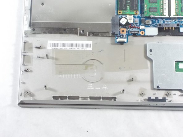

  4. Sony Vaio SVT151A11L USB Port Board Replacement: crwdns2935265:04crwdnd2935265:01crwdnd2935265:03crwdne2935265:0 Sony Vaio SVT151A11L USB Port Board Replacement: crwdns2935265:04crwdnd2935265:02crwdnd2935265:03crwdne2935265:0 Sony Vaio SVT151A11L USB Port Board Replacement: crwdns2935265:04crwdnd2935265:03crwdnd2935265:03crwdne2935265:0
    • Grab the disk drive located at the edge of the computer and pull it it out.
    • Unscrew the three 7 mm screws with a JIS #0 screwdriver.

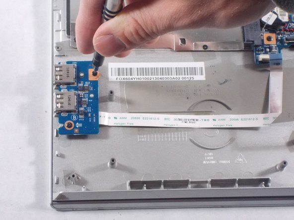

  5. Sony Vaio SVT151A11L USB Port Board Replacement, USB Port Board: crwdns2935265:05crwdnd2935265:01crwdnd2935265:02crwdne2935265:0 Sony Vaio SVT151A11L USB Port Board Replacement, USB Port Board: crwdns2935265:05crwdnd2935265:02crwdnd2935265:02crwdne2935265:0
    • Use a JIS #0 screwdriver to unscrew the two 4mm screws from the board.

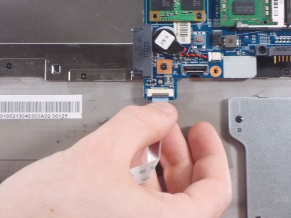

  6. Sony Vaio SVT151A11L USB Port Board Replacement: crwdns2935265:06crwdnd2935265:01crwdnd2935265:03crwdne2935265:0 Sony Vaio SVT151A11L USB Port Board Replacement: crwdns2935265:06crwdnd2935265:02crwdnd2935265:03crwdne2935265:0 Sony Vaio SVT151A11L USB Port Board Replacement: crwdns2935265:06crwdnd2935265:03crwdnd2935265:03crwdne2935265:0
    • Lift board and peel the ribbon cable from the computer.
    • Lift and pull the end of the ribbon cable to remove it from the slot.
