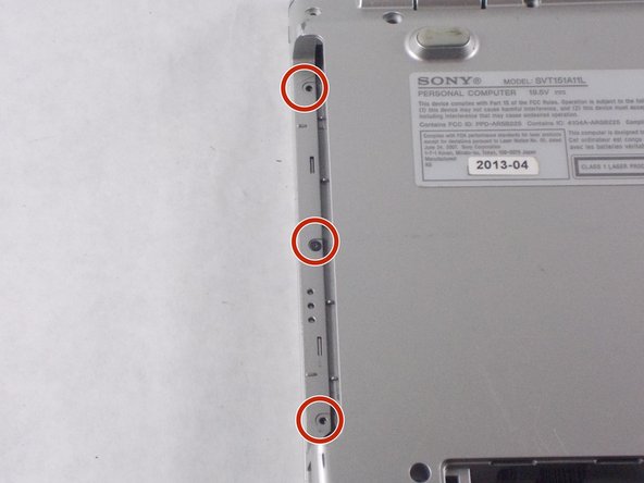

  3. Sony Vaio SVT151A11L Multimedia Card Replacement, Back Panel: crwdns2935265:03crwdnd2935265:01crwdnd2935265:03crwdne2935265:0 Sony Vaio SVT151A11L Multimedia Card Replacement, Back Panel: crwdns2935265:03crwdnd2935265:02crwdnd2935265:03crwdne2935265:0 Sony Vaio SVT151A11L Multimedia Card Replacement, Back Panel: crwdns2935265:03crwdnd2935265:03crwdnd2935265:03crwdne2935265:0
    • Unscrew the three 4mm screws using a JIS #0 screwdriver.
    • Unscrew the eight 7 mm screws using a JIS #0 screwdriver.
    • Grab and lift the edge of the panel to pull it free from the rest of the computer.

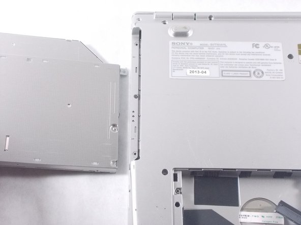

  4. Sony Vaio SVT151A11L Multimedia Card Replacement: crwdns2935265:04crwdnd2935265:01crwdnd2935265:03crwdne2935265:0 Sony Vaio SVT151A11L Multimedia Card Replacement: crwdns2935265:04crwdnd2935265:02crwdnd2935265:03crwdne2935265:0 Sony Vaio SVT151A11L Multimedia Card Replacement: crwdns2935265:04crwdnd2935265:03crwdnd2935265:03crwdne2935265:0
    • Grab the disk drive located at the edge of the computer and pull it it out.
    • Unscrew the three 7 mm screws with a JIS #0 screwdriver.

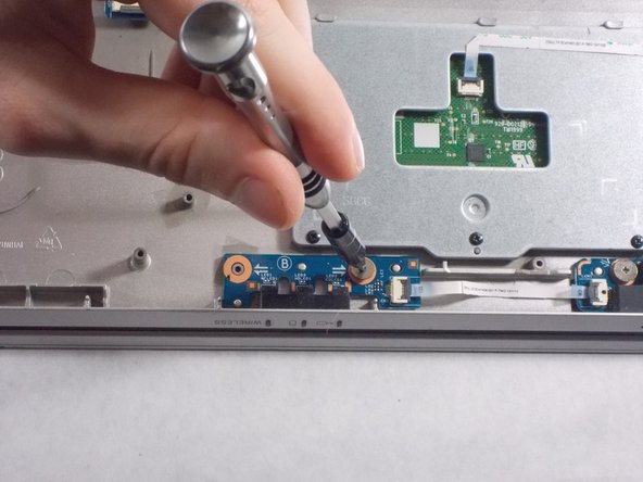

  6. Sony Vaio SVT151A11L Multimedia Card Replacement: crwdns2935265:06crwdnd2935265:01crwdnd2935265:02crwdne2935265:0 Sony Vaio SVT151A11L Multimedia Card Replacement: crwdns2935265:06crwdnd2935265:02crwdnd2935265:02crwdne2935265:0
    • Unscrew the two 2mm screws from the board using JIS #0 screwdriver.

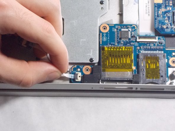

    • Lift up multimedia card.
    • Pull out ribbon cable from connected board.
