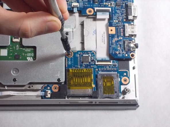

  5. Sony Vaio SVT151A11L Multimedia Card Reader Replacement, Multimedia Card: crwdns2935265:05crwdnd2935265:01crwdnd2935265:01crwdne2935265:0
    • Get unobstructed access to the multimedia card.
  6. Sony Vaio SVT151A11L Multimedia Card Reader Replacement: crwdns2935265:06crwdnd2935265:01crwdnd2935265:02crwdne2935265:0 Sony Vaio SVT151A11L Multimedia Card Reader Replacement: crwdns2935265:06crwdnd2935265:02crwdnd2935265:02crwdne2935265:0
    • Unscrew the two 2mm screws from the board using JIS #0 screwdriver.
  7. Sony Vaio SVT151A11L Multimedia Card Reader Replacement: crwdns2935265:07crwdnd2935265:01crwdnd2935265:02crwdne2935265:0 Sony Vaio SVT151A11L Multimedia Card Reader Replacement: crwdns2935265:07crwdnd2935265:02crwdnd2935265:02crwdne2935265:0
    • Lift up multimedia card.
    • Pull out ribbon cable from connected board.

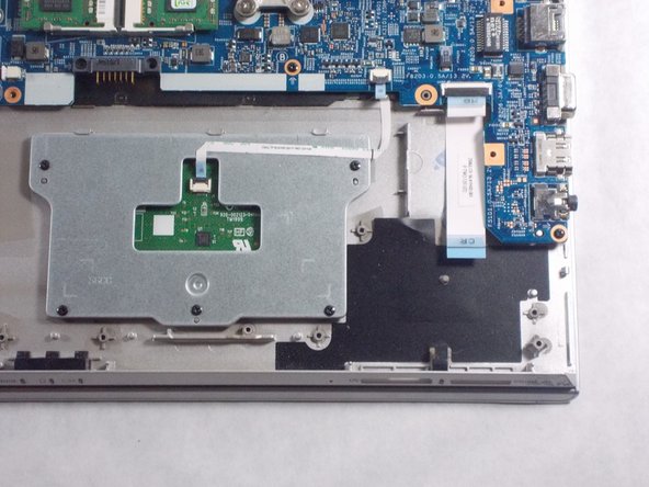

  8. Sony Vaio SVT151A11L Multimedia Card Reader Replacement, Multimedia Card Reader: crwdns2935265:08crwdnd2935265:01crwdnd2935265:01crwdne2935265:0
    • Get unobstructed access to the multimedia card reader.
  9. Sony Vaio SVT151A11L Multimedia Card Reader Replacement: crwdns2935265:09crwdnd2935265:01crwdnd2935265:02crwdne2935265:0 Sony Vaio SVT151A11L Multimedia Card Reader Replacement: crwdns2935265:09crwdnd2935265:02crwdnd2935265:02crwdne2935265:0
    • Unscrew three 2mm screws using JIS #0 screwdriver.
  10. Sony Vaio SVT151A11L Multimedia Card Reader Replacement: crwdns2935265:010crwdnd2935265:01crwdnd2935265:02crwdne2935265:0 Sony Vaio SVT151A11L Multimedia Card Reader Replacement: crwdns2935265:010crwdnd2935265:02crwdnd2935265:02crwdne2935265:0
    • Gently lift up multimedia card reader.
    • Pull out ribbon cable from the board.
