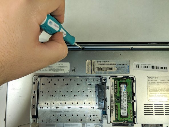

  2. Sony Vaio SVT131A11L Keyboard Replacement, Motherboard: crwdns2935265:02crwdnd2935265:01crwdnd2935265:01crwdne2935265:0
    • The Hard Drive bay cover has three Phillips head screws at two different lengths. Be sure to organize your screws, as improper replacement will result in damage to your device.
    • The middle Phillips head screw is 10mm in length and will only fit in this thread. Unscrew the 10mm Phillips head screw and keep it separate from the other two screws in this step.
    • Unscrew the two remaining 5mm Phillips head screws on the left and right side of the hard drive bay cover.
    • Lift the panel to remove it.

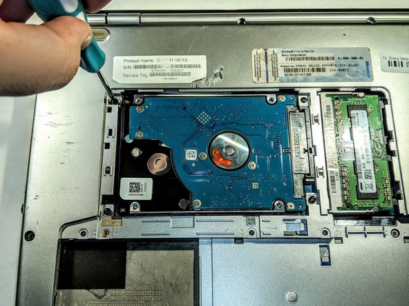

  3. Sony Vaio SVT131A11L Keyboard Replacement: crwdns2935265:03crwdnd2935265:01crwdnd2935265:02crwdne2935265:0 Sony Vaio SVT131A11L Keyboard Replacement: crwdns2935265:03crwdnd2935265:02crwdnd2935265:02crwdne2935265:0
    • Remove the three 5mm Phillips head screws that secure the Hard Drive bay to the back panel.
  4. Sony Vaio SVT131A11L Keyboard Replacement: crwdns2935265:04crwdnd2935265:01crwdnd2935265:01crwdne2935265:0

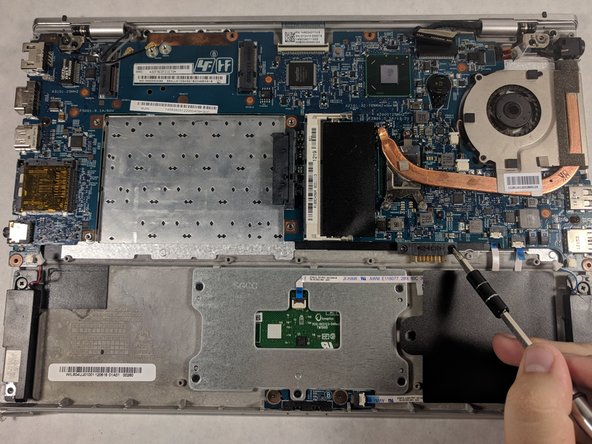

    • Remove the Hard Drive bay by gently pulling the black plastic tab away from the SATA connector.
    • When removing the hard drive bay, it is important not to pull the black tab too hard; it may rip off/cause damage to the SATA connector, resulting in much bigger issues.
    • Using a plastic pry-tool to push the drive away from the SATA connector can also help at this step.

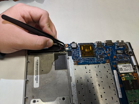

  7. Sony Vaio SVT131A11L Keyboard Replacement: crwdns2935265:07crwdnd2935265:01crwdnd2935265:02crwdne2935265:0 Sony Vaio SVT131A11L Keyboard Replacement: crwdns2935265:07crwdnd2935265:02crwdnd2935265:02crwdne2935265:0
    • Using a pair of tweezers, remove the two cables connecting both speakers to the motherboard panel.

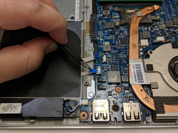

    • Locate the ribbon cable connecting the trackpad to the motherboard.
    • Lift the white plastic tab holding the ribbon cable in place to release it.
    • Remove the ribbon cable by pulling the blue tab away from the motherboard.

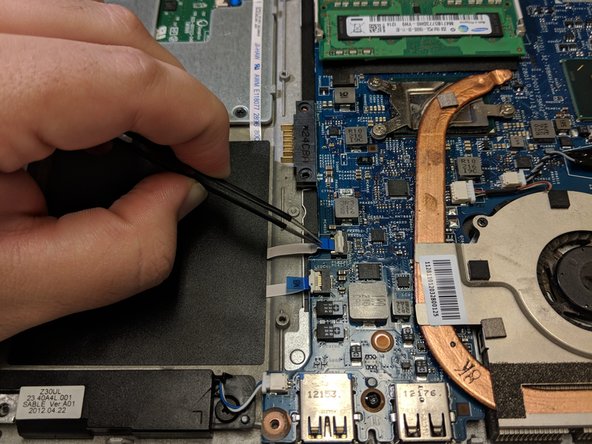

  9. Sony Vaio SVT131A11L Keyboard Replacement: crwdns2935265:09crwdnd2935265:01crwdnd2935265:02crwdne2935265:0 Sony Vaio SVT131A11L Keyboard Replacement: crwdns2935265:09crwdnd2935265:02crwdnd2935265:02crwdne2935265:0
    • Locate the ribbon cable connecting the LED Array to the motherboard.

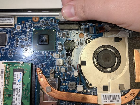

    • Locate the cable that connects the charging port to the motherboard.
    • Grab the head of the cable and pull up and away from motherboard to disconnect it.
    • Be sure to remove the AC adapter from the laptop before attempting this step. A plastic spudger will also work here, and will not pose a risk of shorting out any components on the motherboard.

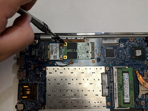

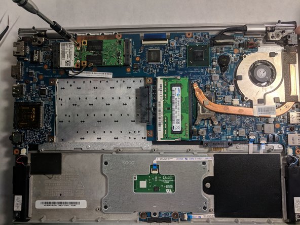

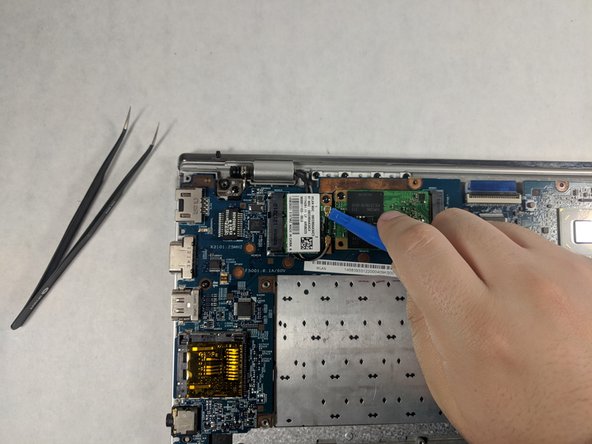

    • Locate the wireless network interface card (NIC) above the area where the hard drive bay sits normally.
    • Using a plastic opening tool, remove the two cable head wires connecting the NIC to the motherboard.
  13. Sony Vaio SVT131A11L Keyboard Replacement: crwdns2935265:013crwdnd2935265:01crwdnd2935265:02crwdne2935265:0 Sony Vaio SVT131A11L Keyboard Replacement: crwdns2935265:013crwdnd2935265:02crwdnd2935265:02crwdne2935265:0
    • Unscrew the 5mm Phillips head screw holding the NIC to the motherboard.
    • Remove the NIC from the PCIe slot on the motherboard.

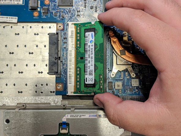

    • Locate the Random Access Memory (RAM) card on the motherboard.
    • Pull the two metal clips securing the RAM apart, releasing the card from the DIMM slot.
    • Remove the RAM from the motherboard, be sure to store this safely as your replacement motherboard with NOT come with a new one.

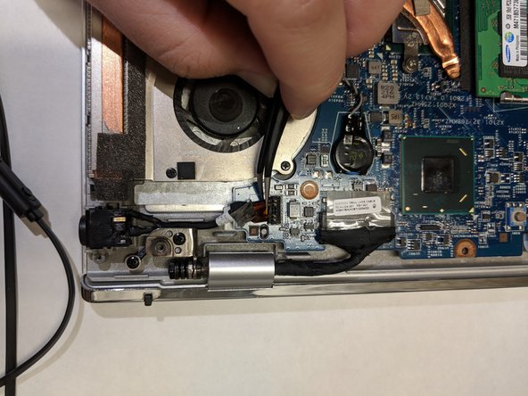

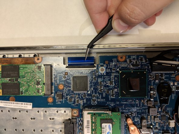

    • Locate the display cable connecting the keyboard to the motherboard.
    • Grab the clear plastic tab attached to the top of the connector, and pull away from the motherboard to separate it from the board.

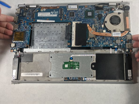

    • Unscrew the three 5mm Phillips head screws holding the motherboard to the laptop.
    • Grab the edges of the motherboard and lift the it slowly up and away from the back panel of the laptop.
    • It's best to lift the board away from the case by using the USB headers on the sides for leverage. Be careful when touching components on the motherboard, as oils from your skin can cause them to short out.

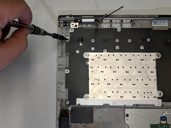

    • Unscrew the sixteen 3mm Phillips head screws that secure the metal back plate to the keyboard.
    • Grab the edges of the metal back plate that covers the keyboard and remove it.
    • The keyboard will be exposed at this point, simply lift the keyboard from the edges to remove it from the bottom panel of the laptop.
