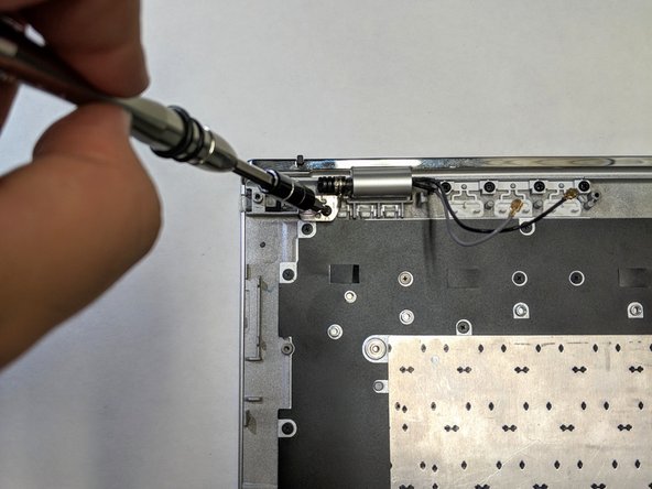

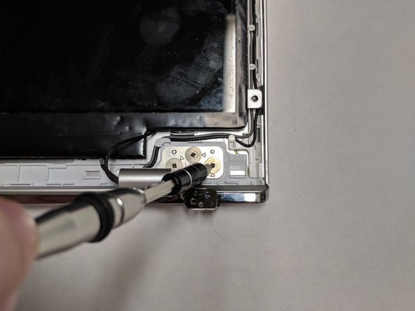

    1. Sony Vaio SVT131A11L Display Replacement, Display: crwdns2935265:018crwdnd2935265:01crwdnd2935265:02crwdne2935265:0 Sony Vaio SVT131A11L Display Replacement, Display: crwdns2935265:018crwdnd2935265:02crwdnd2935265:02crwdne2935265:0
      • Unscrew the two 5mm Phillips head screws that secure the two display hinges to the back panel of the laptop.
      • Carefully lift the metal hinges that secure the top panel to the bottom panel of the laptop.
      • This will take a bit of force if you're lifting the hinges directly. We've found that lifting the bottom panel of the laptop as a whole gives a bit more leverage and makes this step easier.
      • Slowly slide the bottom panel of the laptop out from under the metal hinges. Your display panel will now be separated from the rest of your device.

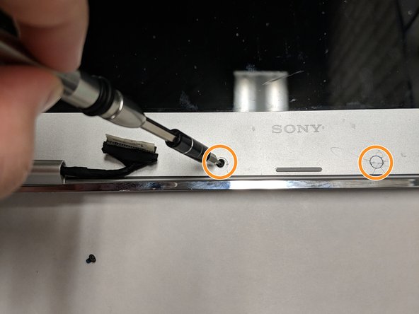

    2. Sony Vaio SVT131A11L Display Replacement: crwdns2935265:019crwdnd2935265:01crwdnd2935265:03crwdne2935265:0 Sony Vaio SVT131A11L Display Replacement: crwdns2935265:019crwdnd2935265:02crwdnd2935265:03crwdne2935265:0 Sony Vaio SVT131A11L Display Replacement: crwdns2935265:019crwdnd2935265:03crwdnd2935265:03crwdne2935265:0
      • Locate the round plastic covers and pry them off with a thin pry tool or pair of tweezers to reveal two 5mm Phillips heads screws.
      • Unscrew the two 5mm Phillips head screws.

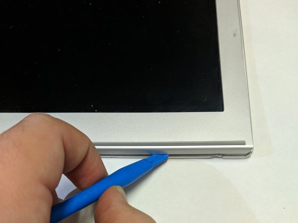

      • Using a prying tool, pry around the edge of the front screen panel, separating the plastic edges of the panel.
      • Take your time when using the prying tool as there is a possibility of damaging the plastic frame.

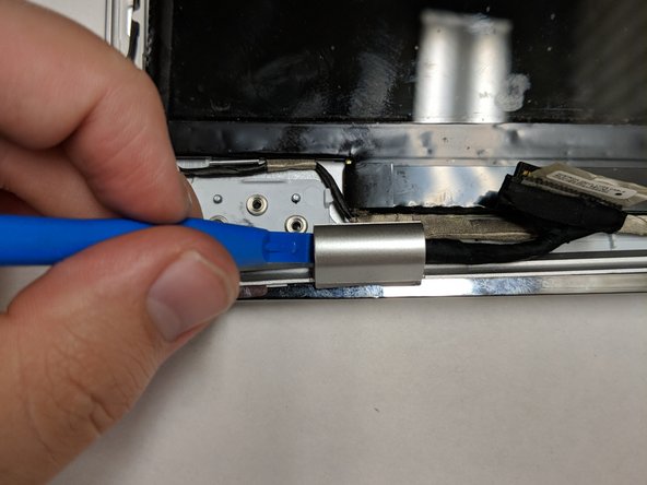

      • Using a pry tool, separate the plastic housing that holds the hinges in place from the display panel.
      • Pry open the housing of the display cable in order to completely remove it from the top panel of the laptop.
      • While it isn't necessary to remove the plastic housing mentioned in the first part of this step, it helps prying open the display cable housing by offering more space to work.

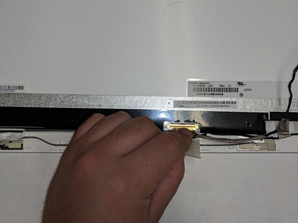

    6. Sony Vaio SVT131A11L Display Replacement: crwdns2935265:023crwdnd2935265:01crwdnd2935265:02crwdne2935265:0 Sony Vaio SVT131A11L Display Replacement: crwdns2935265:023crwdnd2935265:02crwdnd2935265:02crwdne2935265:0
      • Separate the display cable by removing it from the plastic clips that hold it in place along the edge of the display panel.
      • After the cable is detached from the panel, lift the display up and remove it from the display panel.
