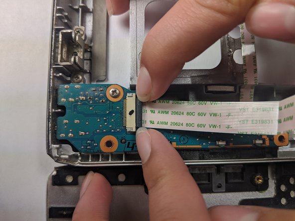

  6. Sony Vaio SVS151190X Disk Reader Replacement: crwdns2935265:06crwdnd2935265:01crwdnd2935265:02crwdne2935265:0 Sony Vaio SVS151190X Disk Reader Replacement: crwdns2935265:06crwdnd2935265:02crwdnd2935265:02crwdne2935265:0
    • The ribbon wire that attaches the keyboard and bottom cover is fragile, take care during removal.
    • Remove the keyboard from the bottom cover and place it down as demonstrated.
    • Carefully pull the plastic tab and remove the ribbon wire.

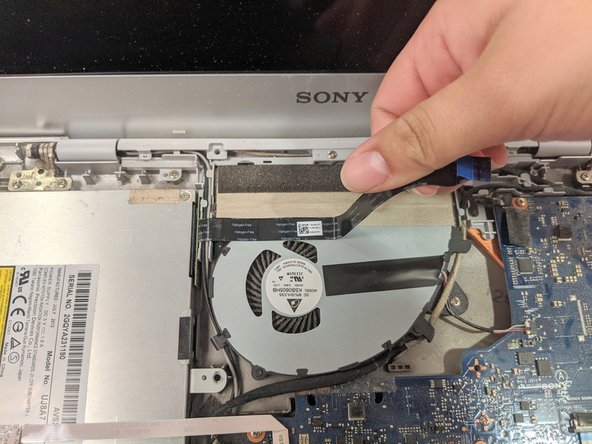

  7. Sony Vaio SVS151190X Disk Reader Replacement: crwdns2935265:07crwdnd2935265:01crwdnd2935265:02crwdne2935265:0 Sony Vaio SVS151190X Disk Reader Replacement: crwdns2935265:07crwdnd2935265:02crwdnd2935265:02crwdne2935265:0
    • Slightly pull up the black tape covering the disk drive's ribbon wire.
    • Pull up the blue plastic strip attached to the ribbon wire and remove the ribbon wire from the port.
    • Detach the ribbon wire from the fan so the disk reader can be removed.

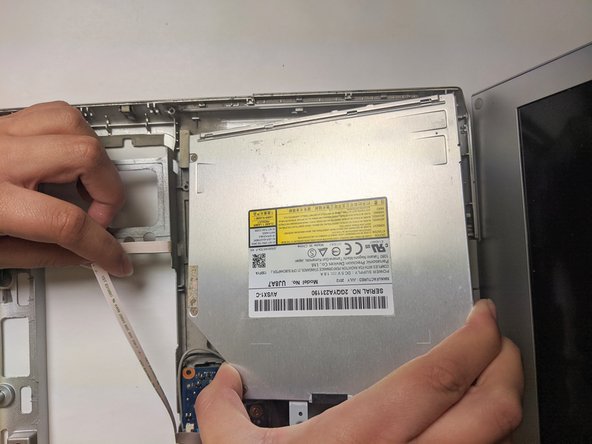

  9. Sony Vaio SVS151190X Disk Reader Replacement: crwdns2935265:09crwdnd2935265:01crwdnd2935265:02crwdne2935265:0 Sony Vaio SVS151190X Disk Reader Replacement: crwdns2935265:09crwdnd2935265:02crwdnd2935265:02crwdne2935265:0
    • Take out the black plastic covering.
    • Remove the disk reader.
