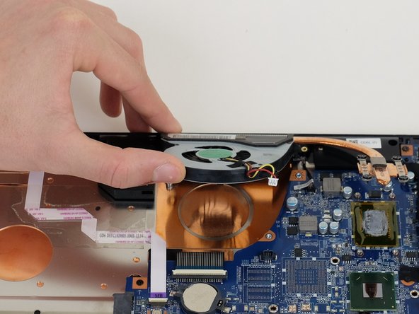

  7. Sony Vaio SVF15A16CXB Fan  Replacement: crwdns2935265:07crwdnd2935265:01crwdnd2935265:01crwdne2935265:0
    • Unscrew the four 4mm screws from the connecting copper piece. The two screws are located on either side of the copper piece.
    • The 4 mm screws won’t come out but the fan will, the screws are just to hold the fan in place.
  8. Sony Vaio SVF15A16CXB Fan  Replacement: crwdns2935265:08crwdnd2935265:01crwdnd2935265:02crwdne2935265:0 Sony Vaio SVF15A16CXB Fan  Replacement: crwdns2935265:08crwdnd2935265:02crwdnd2935265:02crwdne2935265:0
    • Gently pull off the fan from the motherboard.
