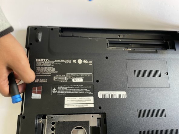

    • Turn the laptop over so its underside is facing upwards and visible.
  2. Sony Vaio SVE171C11L Speaker Replacement: crwdns2935265:02crwdnd2935265:01crwdnd2935265:01crwdne2935265:0
    • Once you flip the laptop over, make sure the right tab is pushed upwards to unlock it.
    • Use your left hand to push up the left tab to release the battery.
  3. Sony Vaio SVE171C11L Speaker Replacement: crwdns2935265:03crwdnd2935265:01crwdnd2935265:01crwdne2935265:0
    • After the battery is released, locate the small gap where the battery and the shell meet. Then lift the gap up and rotate the battery up and away from yourself.
  4. Sony Vaio SVE171C11L Speaker Replacement: crwdns2935265:04crwdnd2935265:01crwdnd2935265:01crwdne2935265:0
    • Pull the battery away.
  5. Sony Vaio SVE171C11L Speaker Replacement, Hard Drive: crwdns2935265:05crwdnd2935265:01crwdnd2935265:01crwdne2935265:0
    • Use a Phillips #00 screwdriver to remove the two screws that secure the hard drive cover.
  6. Sony Vaio SVE171C11L Speaker Replacement: crwdns2935265:06crwdnd2935265:01crwdnd2935265:02crwdne2935265:0 Sony Vaio SVE171C11L Speaker Replacement: crwdns2935265:06crwdnd2935265:02crwdnd2935265:02crwdne2935265:0
    • After the screw have been removed, pop the hard drive cover open.

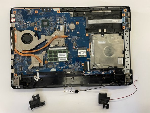

  9. Sony Vaio SVE171C11L Speaker Replacement, Speaker: crwdns2935265:09crwdnd2935265:01crwdnd2935265:02crwdne2935265:0 Sony Vaio SVE171C11L Speaker Replacement, Speaker: crwdns2935265:09crwdnd2935265:02crwdnd2935265:02crwdne2935265:0
    • Remove the eleven 3mm flathead screws that surround the back panel.
    • Remove the back cover.
  10. Sony Vaio SVE171C11L Speaker Replacement: crwdns2935265:010crwdnd2935265:01crwdnd2935265:01crwdne2935265:0
    • On the left speaker, unplug the cable that is in the way so you can remove the left speaker safely.
  11. Sony Vaio SVE171C11L Speaker Replacement: crwdns2935265:011crwdnd2935265:01crwdnd2935265:01crwdne2935265:0
    • Remove the single screw at the bottom of the speaker
  12. Sony Vaio SVE171C11L Speaker Replacement: crwdns2935265:012crwdnd2935265:01crwdnd2935265:01crwdne2935265:0
    • Remove the 2 black scews that at the top of the speaker.
  13. Sony Vaio SVE171C11L Speaker Replacement: crwdns2935265:013crwdnd2935265:01crwdnd2935265:02crwdne2935265:0 Sony Vaio SVE171C11L Speaker Replacement: crwdns2935265:013crwdnd2935265:02crwdnd2935265:02crwdne2935265:0
    • Carefully remove the speaker. Keep watch no wiring is in the way.
    • Do this to both sides to remove the second speaker.
