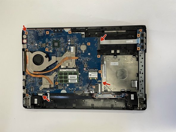

  5. Sony Vaio SVE171C11L Motherboard Replacement: crwdns2935265:05crwdnd2935265:01crwdnd2935265:03crwdne2935265:0 Sony Vaio SVE171C11L Motherboard Replacement: crwdns2935265:05crwdnd2935265:02crwdnd2935265:03crwdne2935265:0 Sony Vaio SVE171C11L Motherboard Replacement: crwdns2935265:05crwdnd2935265:03crwdnd2935265:03crwdne2935265:0
    • Remove the cables from the fan and unscrew the heatsink.
    • The heatsink has many metal pieces jutting out from its base and is located under the fan.

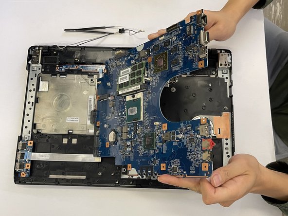

    • Carefully disconnect the tabs on the edges of the motherboard.
    • Unscrew the screws holding the motherboard in place. Set them aside.
    • On the underside of the motherboard, disconnect the keyboard from the motherboard.
    • Once ALL cables are disconnected, carefully remove the motherboard.
