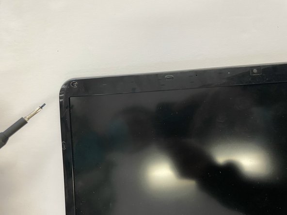

  12. Sony Vaio SVE171C11L Display Replacement: crwdns2935265:012crwdnd2935265:01crwdnd2935265:02crwdne2935265:0 Sony Vaio SVE171C11L Display Replacement: crwdns2935265:012crwdnd2935265:02crwdnd2935265:02crwdne2935265:0
    • Remove the four 5mm screws on the corners of the display case.
  13. Sony Vaio SVE171C11L Display Replacement: crwdns2935265:013crwdnd2935265:01crwdnd2935265:01crwdne2935265:0
    • Use the pick around the case to help detach them.

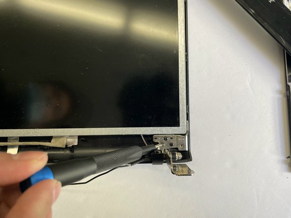

  14. Sony Vaio SVE171C11L Display Replacement: crwdns2935265:014crwdnd2935265:01crwdnd2935265:02crwdne2935265:0 Sony Vaio SVE171C11L Display Replacement: crwdns2935265:014crwdnd2935265:02crwdnd2935265:02crwdne2935265:0
    • Remove the three 2mm screws that are on each hinge.
