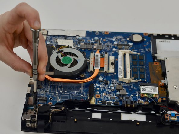

  7. Sony Vaio SVE151G11L Webcam Replacement: crwdns2935265:07crwdnd2935265:01crwdnd2935265:01crwdne2935265:0
    • Remove antenna wires attached to the WiFi card using a plastic opening tool.
  8. Sony Vaio SVE151G11L Webcam Replacement: crwdns2935265:08crwdnd2935265:01crwdnd2935265:01crwdne2935265:0
    • Remove the other antenna wire.
  9. Sony Vaio SVE151G11L Webcam Replacement: crwdns2935265:09crwdnd2935265:01crwdnd2935265:01crwdne2935265:0
    • Remove the display cable by pulling upwards.
  10. Sony Vaio SVE151G11L Webcam Replacement: crwdns2935265:010crwdnd2935265:01crwdnd2935265:01crwdne2935265:0
    • Remove the power display cable with a plastic opening tool by pushing outwards.
  11. Sony Vaio SVE151G11L Webcam Replacement: crwdns2935265:011crwdnd2935265:01crwdnd2935265:02crwdne2935265:0 Sony Vaio SVE151G11L Webcam Replacement: crwdns2935265:011crwdnd2935265:02crwdnd2935265:02crwdne2935265:0
    • Remove 4 hinge screws with a Phillips #0 screwdriver.
  12. Sony Vaio SVE151G11L Webcam Replacement: crwdns2935265:012crwdnd2935265:01crwdnd2935265:02crwdne2935265:0 Sony Vaio SVE151G11L Webcam Replacement: crwdns2935265:012crwdnd2935265:02crwdnd2935265:02crwdne2935265:0
    • Lift upward on the hinges with a plastic opening tool to release them.

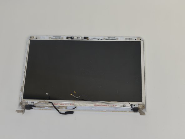

  13. Sony Vaio SVE151G11L Webcam Replacement: crwdns2935265:013crwdnd2935265:01crwdnd2935265:01crwdne2935265:0
    • Separate the bottom of the laptop from the monitor.
  14. Sony Vaio SVE151G11L Webcam Replacement: crwdns2935265:014crwdnd2935265:01crwdnd2935265:01crwdne2935265:0
    • Completely detach screen from the laptop.
  15. Sony Vaio SVE151G11L Webcam Replacement, Webcam: crwdns2935265:015crwdnd2935265:01crwdnd2935265:01crwdne2935265:0
    • Remove the rubber nipples to expose the screws using the pointed side of the spudger.
  16. Sony Vaio SVE151G11L Webcam Replacement: crwdns2935265:016crwdnd2935265:01crwdnd2935265:01crwdne2935265:0
    • Remove each of the screws revealed from the step below with a P00 screwdriver.

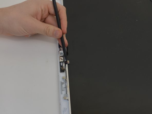

  18. Sony Vaio SVE151G11L Webcam Replacement: crwdns2935265:018crwdnd2935265:01crwdnd2935265:02crwdne2935265:0 Sony Vaio SVE151G11L Webcam Replacement: crwdns2935265:018crwdnd2935265:02crwdnd2935265:02crwdne2935265:0
    • Remove the camera cable with the spudger.
  19. Sony Vaio SVE151G11L Webcam Replacement: crwdns2935265:019crwdnd2935265:01crwdnd2935265:01crwdne2935265:0
    • Remove screws on both sides using a P000 screwdriver.
  20. Sony Vaio SVE151G11L Webcam Replacement: crwdns2935265:020crwdnd2935265:01crwdnd2935265:01crwdne2935265:0
    • Pop out the board using a spudger.
  21. Sony Vaio SVE151G11L Webcam Replacement: crwdns2935265:021crwdnd2935265:01crwdnd2935265:01crwdne2935265:0
    • The board is now removed.
