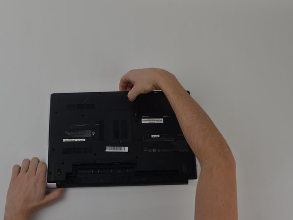

    • Turn the laptop over so its underside is facing upwards and visible.
  2. Sony Vaio SVE151G11L Speaker Replacement: crwdns2935265:02crwdnd2935265:01crwdnd2935265:01crwdne2935265:0
    • Standing so that the barcode and warning labels are upright and legible, push the left tab up and away from yourself.
  3. Sony Vaio SVE151G11L Speaker Replacement: crwdns2935265:03crwdnd2935265:01crwdnd2935265:01crwdne2935265:0
    • Standing so that the barcode and warning labels are upright and legible, push the right tab up and away from yourself.
  4. Sony Vaio SVE151G11L Speaker Replacement: crwdns2935265:04crwdnd2935265:01crwdnd2935265:01crwdne2935265:0
    • Locate the small gap where the battery and the laptop shell meet. Lift from the gap and rotate the battery up and away from yourself.
  5. Sony Vaio SVE151G11L Speaker Replacement: crwdns2935265:05crwdnd2935265:01crwdnd2935265:01crwdne2935265:0
    • Pull battery away from laptop.

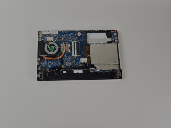

    • Remove the back cover.
  12. Sony Vaio SVE151G11L Speaker Replacement: crwdns2935265:012crwdnd2935265:01crwdnd2935265:02crwdne2935265:0 Sony Vaio SVE151G11L Speaker Replacement: crwdns2935265:012crwdnd2935265:02crwdnd2935265:02crwdne2935265:0

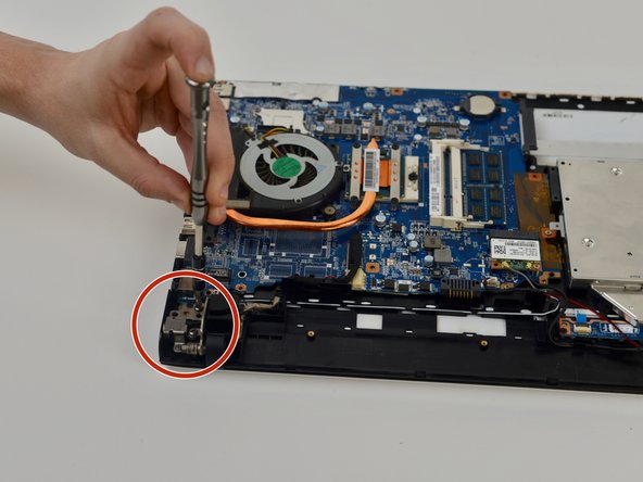

    • Remove 4 hinge screws with a Phillips #0 screwdriver.
  13. Sony Vaio SVE151G11L Speaker Replacement: crwdns2935265:013crwdnd2935265:01crwdnd2935265:03crwdne2935265:0 Sony Vaio SVE151G11L Speaker Replacement: crwdns2935265:013crwdnd2935265:02crwdnd2935265:03crwdne2935265:0 Sony Vaio SVE151G11L Speaker Replacement: crwdns2935265:013crwdnd2935265:03crwdnd2935265:03crwdne2935265:0
    • Pop open hinge.
    • Remove black screw size P000.

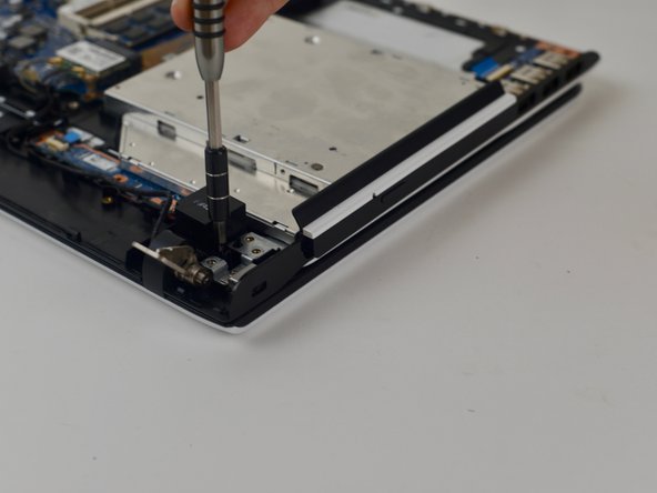

  14. Sony Vaio SVE151G11L Speaker Replacement: crwdns2935265:014crwdnd2935265:01crwdnd2935265:02crwdne2935265:0 Sony Vaio SVE151G11L Speaker Replacement: crwdns2935265:014crwdnd2935265:02crwdnd2935265:02crwdne2935265:0
    • Remove wiring along its guide.

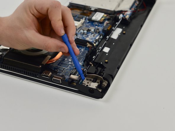

  15. Sony Vaio SVE151G11L Speaker Replacement: crwdns2935265:015crwdnd2935265:01crwdnd2935265:03crwdne2935265:0 Sony Vaio SVE151G11L Speaker Replacement: crwdns2935265:015crwdnd2935265:02crwdnd2935265:03crwdne2935265:0 Sony Vaio SVE151G11L Speaker Replacement: crwdns2935265:015crwdnd2935265:03crwdnd2935265:03crwdne2935265:0
    • Remove two hinge screws size P00.
    • Pop open hinge.

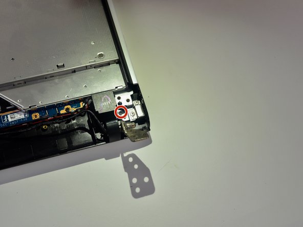

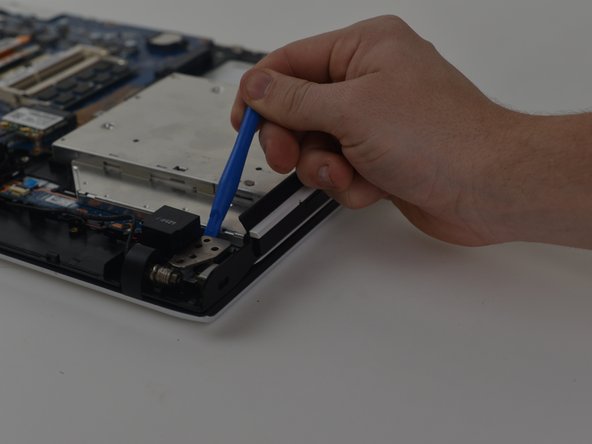

  16. Sony Vaio SVE151G11L Speaker Replacement: crwdns2935265:016crwdnd2935265:01crwdnd2935265:02crwdne2935265:0 Sony Vaio SVE151G11L Speaker Replacement: crwdns2935265:016crwdnd2935265:02crwdnd2935265:02crwdne2935265:0
    • Remove black screw.

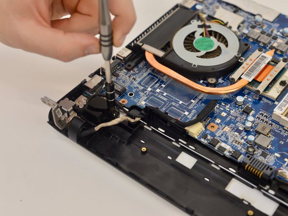

  17. Sony Vaio SVE151G11L Speaker Replacement: crwdns2935265:017crwdnd2935265:01crwdnd2935265:02crwdne2935265:0 Sony Vaio SVE151G11L Speaker Replacement: crwdns2935265:017crwdnd2935265:02crwdnd2935265:02crwdne2935265:0
    • Remove secondary black screw.

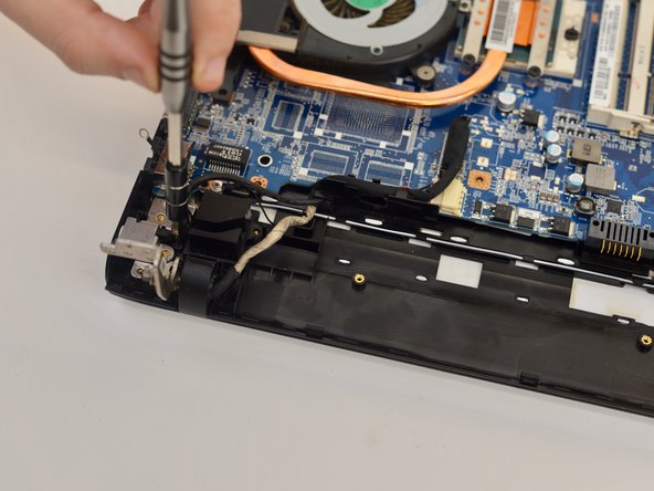

  18. Sony Vaio SVE151G11L Speaker Replacement: crwdns2935265:018crwdnd2935265:01crwdnd2935265:01crwdne2935265:0
    • Remove speaker.
  19. Sony Vaio SVE151G11L Speaker Replacement: crwdns2935265:019crwdnd2935265:01crwdnd2935265:02crwdne2935265:0 Sony Vaio SVE151G11L Speaker Replacement: crwdns2935265:019crwdnd2935265:02crwdnd2935265:02crwdne2935265:0

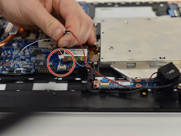

    • Follow wire down its wire channel and remove it from the channel.
    • Pull up on the connector to disconnect the speakers to the motherboard.

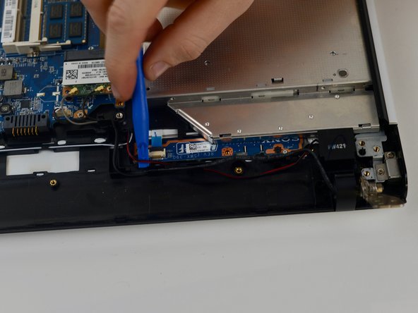

  20. Sony Vaio SVE151G11L Speaker Replacement: crwdns2935265:020crwdnd2935265:01crwdnd2935265:01crwdne2935265:0
    • Remove speaker and wire from the laptop.
