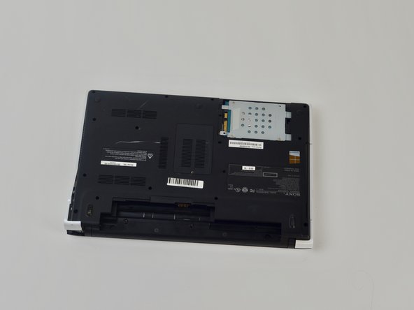

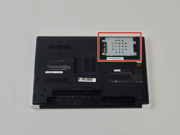

  6. Sony Vaio SVE151G11L Motherboard Replacement, Hard Disk Drive: crwdns2935265:06crwdnd2935265:01crwdnd2935265:01crwdne2935265:0
    • Flip laptop over so the bottom is facing upwards.
  7. Sony Vaio SVE151G11L Motherboard Replacement: crwdns2935265:07crwdnd2935265:01crwdnd2935265:01crwdne2935265:0
    • Remove 2 bottom screws in the top right on the HDD cover, with a size P000 screwdriver.
  8. Sony Vaio SVE151G11L Motherboard Replacement: crwdns2935265:08crwdnd2935265:01crwdnd2935265:02crwdne2935265:0 Sony Vaio SVE151G11L Motherboard Replacement: crwdns2935265:08crwdnd2935265:02crwdnd2935265:02crwdne2935265:0
    • Pop open the cover to the HDD.
  9. Sony Vaio SVE151G11L Motherboard Replacement: crwdns2935265:09crwdnd2935265:01crwdnd2935265:01crwdne2935265:0
    • Remove the screws on the HDD with a Phillips #000 screwdriver.
  10. Sony Vaio SVE151G11L Motherboard Replacement: crwdns2935265:010crwdnd2935265:01crwdnd2935265:02crwdne2935265:0 Sony Vaio SVE151G11L Motherboard Replacement: crwdns2935265:010crwdnd2935265:02crwdnd2935265:02crwdne2935265:0
    • Pull plastic tab away from the laptop.
    • Lift HDD away from laptop.

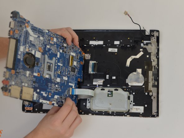

  11. Sony Vaio SVE151G11L Motherboard Replacement, Motherboard: crwdns2935265:011crwdnd2935265:01crwdnd2935265:01crwdne2935265:0
    • Flip the laptop over on its backside.
  12. Sony Vaio SVE151G11L Motherboard Replacement: crwdns2935265:012crwdnd2935265:01crwdnd2935265:01crwdne2935265:0
    • Remove the screws holding the motherboard in place.
  13. Sony Vaio SVE151G11L Motherboard Replacement: crwdns2935265:013crwdnd2935265:01crwdnd2935265:02crwdne2935265:0 Sony Vaio SVE151G11L Motherboard Replacement: crwdns2935265:013crwdnd2935265:02crwdnd2935265:02crwdne2935265:0
    • Pop the motherboard away from the frame.
  14. Sony Vaio SVE151G11L Motherboard Replacement: crwdns2935265:014crwdnd2935265:01crwdnd2935265:01crwdne2935265:0
    • Remove the ribbon cable from the motherboard.
  15. Sony Vaio SVE151G11L Motherboard Replacement: crwdns2935265:015crwdnd2935265:01crwdnd2935265:02crwdne2935265:0 Sony Vaio SVE151G11L Motherboard Replacement: crwdns2935265:015crwdnd2935265:02crwdnd2935265:02crwdne2935265:0
    • Remove motherboard from the laptop.
