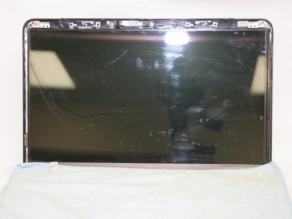

  6. Sony Vaio SVE15112FXS LCD Screen Replacement: crwdns2935265:06crwdnd2935265:01crwdnd2935265:02crwdne2935265:0 Sony Vaio SVE15112FXS LCD Screen Replacement: crwdns2935265:06crwdnd2935265:02crwdnd2935265:02crwdne2935265:0
    • Use a #0 Phillips screwdriver to remove the four 3.0 mm screen screws.
    • Cover the keyboard with a cloth or towel to protect the screen and keep any broken glass out of the keyboard.

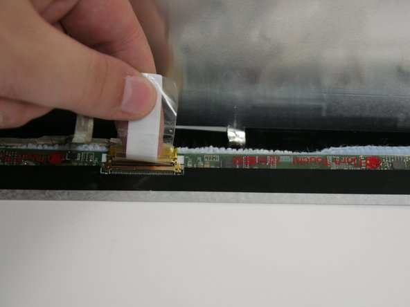

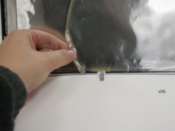

  7. Sony Vaio SVE15112FXS LCD Screen Replacement: crwdns2935265:07crwdnd2935265:01crwdnd2935265:03crwdne2935265:0 Sony Vaio SVE15112FXS LCD Screen Replacement: crwdns2935265:07crwdnd2935265:02crwdnd2935265:03crwdne2935265:0 Sony Vaio SVE15112FXS LCD Screen Replacement: crwdns2935265:07crwdnd2935265:03crwdnd2935265:03crwdne2935265:0
    • Pull the screen toward you and away from the lid until a silver cable behind the screen is visible.
    • Remove the silver cable from the back of the screen. It is glued at the top and the bottom.
    • Do not pull the cable loose from the lid, only remove it from the back of the screen.

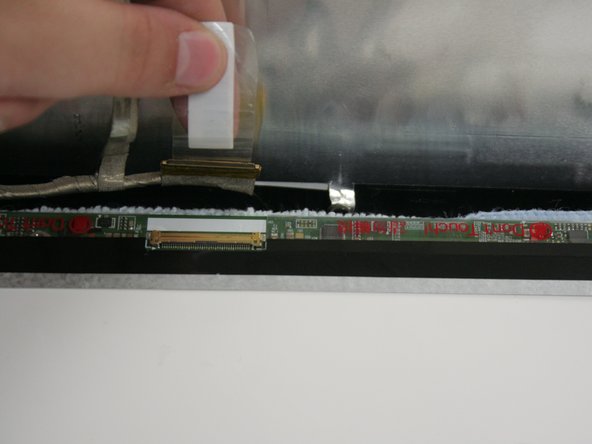

  8. Sony Vaio SVE15112FXS LCD Screen Replacement: crwdns2935265:08crwdnd2935265:01crwdnd2935265:03crwdne2935265:0 Sony Vaio SVE15112FXS LCD Screen Replacement: crwdns2935265:08crwdnd2935265:02crwdnd2935265:03crwdne2935265:0 Sony Vaio SVE15112FXS LCD Screen Replacement: crwdns2935265:08crwdnd2935265:03crwdnd2935265:03crwdne2935265:0
    • Lift the barcode label on the back of the screen upward to loosen the screen cable connector.
    • Once the connector is visible, remove it from the pins on the back of the screen.

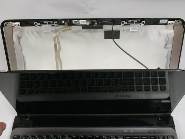

  9. Sony Vaio SVE15112FXS LCD Screen Replacement: crwdns2935265:09crwdnd2935265:01crwdnd2935265:01crwdne2935265:0
    • Lift the screen toward you to remove it completely from the lid.
