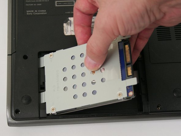

  4. Sony Vaio SVE15112FXS Keyboard Replacement: crwdns2935265:04crwdnd2935265:01crwdnd2935265:01crwdne2935265:0
    • Use a #0 Phillips screwdriver to remove the two 4.0 mm screws attaching the hard drive to the laptop.
  5. Sony Vaio SVE15112FXS Keyboard Replacement: crwdns2935265:05crwdnd2935265:01crwdnd2935265:02crwdne2935265:0 Sony Vaio SVE15112FXS Keyboard Replacement: crwdns2935265:05crwdnd2935265:02crwdnd2935265:02crwdne2935265:0
    • Pull the clear plastic ribbon to the left until the mount is detached from the laptop.
    • There will be some resistance as the hard drive is disconnected. If it does not move at all, check that all anchor screws are removed.
    • Lift the hard drive out of the well.

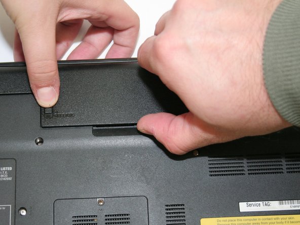

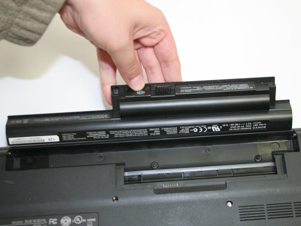

    • Slide the "lock" tab upward to unlock the battery before removal.
    • While pushing the "release" tab upward, lift the battery and pull outward to remove it from the laptop.

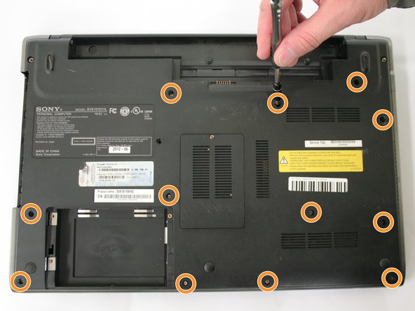

    • To unsecure the back cover, remove all the case screws using a #0 Phillips screwdriver.
    • Remove the two 9.0 mm screws on each side of the battery.
    • Remove the twelve 8.0 mm long screws alongside the entire back cover.
    • Remove the three 3.0 mm screws inside the battery well.
  10. Sony Vaio SVE15112FXS Keyboard Replacement: crwdns2935265:010crwdnd2935265:01crwdnd2935265:03crwdne2935265:0 Sony Vaio SVE15112FXS Keyboard Replacement: crwdns2935265:010crwdnd2935265:02crwdnd2935265:03crwdne2935265:0 Sony Vaio SVE15112FXS Keyboard Replacement: crwdns2935265:010crwdnd2935265:03crwdnd2935265:03crwdne2935265:0

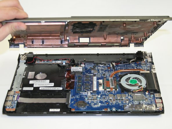

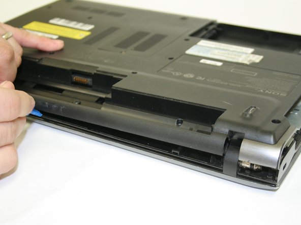

    • Use a plastic opening tool to carefully pry open the latch points located under the silver plastic trim. Repeat this around the back cover.
    • It may be easiest to start around the CD-ROM bay because there is more room.
    • To avoid damaging the plastic trim and cover, do not force difficult areas and make sure the opening tool is completely under the black plastic cover, not just the silver trim.
    • Lift the back cover upward and away from the laptop.

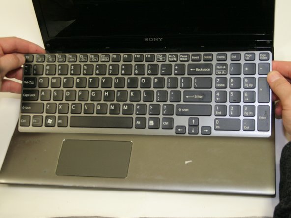

    • Gently push the rectangular opening on the CD-ROM well to loosen the keyboard.
  12. Sony Vaio SVE15112FXS Keyboard Replacement: crwdns2935265:012crwdnd2935265:01crwdnd2935265:02crwdne2935265:0 Sony Vaio SVE15112FXS Keyboard Replacement: crwdns2935265:012crwdnd2935265:02crwdnd2935265:02crwdne2935265:0
    • Use a plastic opening tool to pry upward on the keyboard. Only the top of the keyboard is latched.
    • Lift the keyboard toward you and away from the laptop.
  13. Sony Vaio SVE15112FXS Keyboard Replacement: crwdns2935265:013crwdnd2935265:01crwdnd2935265:02crwdne2935265:0 Sony Vaio SVE15112FXS Keyboard Replacement: crwdns2935265:013crwdnd2935265:02crwdnd2935265:02crwdne2935265:0

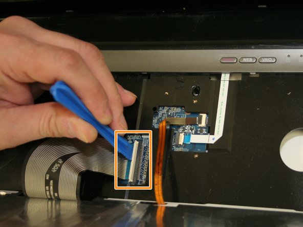

    • Use a plastic opening tool to disconnect the two ZIF connectors attached to each ribbon. Both are located under the keyboard and have a clear flap that must be lifted upward before removal.
    • Open the white connector attached to the copper ribbon.
    • Open the white connected attached to the black and white striped ribbon.
    • Take care when opening these connectors. The ribbon is anchored underneath the clear flap. Pulling these pieces out of their sockets will make it difficult to reassemble them.
    • Lift the keyboard away from the body of the laptop.
