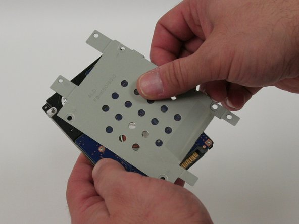

  6. Sony Vaio SVE15112FXS Hard Drive Replacement: crwdns2935265:06crwdnd2935265:01crwdnd2935265:02crwdne2935265:0 Sony Vaio SVE15112FXS Hard Drive Replacement: crwdns2935265:06crwdnd2935265:02crwdnd2935265:02crwdne2935265:0
    • Use a #0 Phillips screwdriver to remove the four 4.0 mm screws attaching the mount to the hard drive.
    • Slide the hard drive away from the mount until it is completely detached.
    • Take note of how the mount is positioned when attached to the hard drive.
