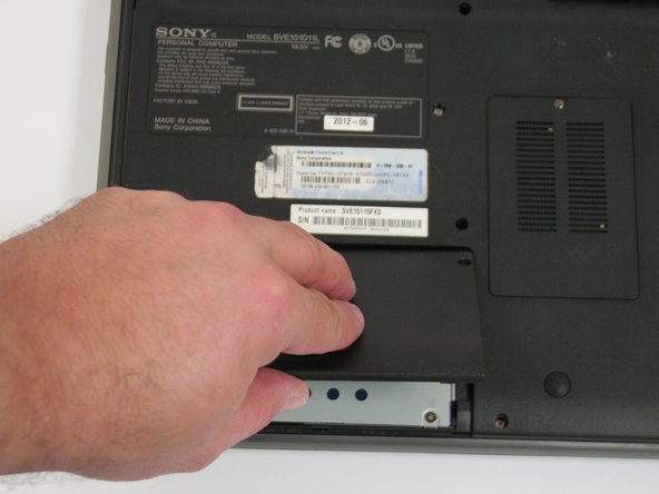

  2. Sony Vaio SVE15112FXS Fan Replacement: crwdns2935265:02crwdnd2935265:01crwdnd2935265:01crwdne2935265:0
    • Use a #0 Phillips screwdriver to remove the two 4.0 mm screws securing the hard drive cover.
    • To avoid losing any parts, we recommend that you place the loose screws on a magnetic project mat.
  3. Sony Vaio SVE15112FXS Fan Replacement: crwdns2935265:03crwdnd2935265:01crwdnd2935265:02crwdne2935265:0 Sony Vaio SVE15112FXS Fan Replacement: crwdns2935265:03crwdnd2935265:02crwdnd2935265:02crwdne2935265:0
    • To expose the hard drive, remove the cover by sliding it toward you and pulling up on the panel.

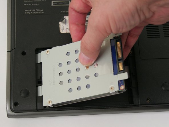

  4. Sony Vaio SVE15112FXS Fan Replacement: crwdns2935265:04crwdnd2935265:01crwdnd2935265:01crwdne2935265:0
    • Use a #0 Phillips screwdriver to remove the two 4.0 mm screws attaching the hard drive to the laptop.
  5. Sony Vaio SVE15112FXS Fan Replacement: crwdns2935265:05crwdnd2935265:01crwdnd2935265:02crwdne2935265:0 Sony Vaio SVE15112FXS Fan Replacement: crwdns2935265:05crwdnd2935265:02crwdnd2935265:02crwdne2935265:0
    • Pull the clear plastic ribbon to the left until the mount is detached from the laptop.
    • There will be some resistance as the hard drive is disconnected. If it does not move at all, check that all anchor screws are removed.
    • Lift the hard drive out of the well.

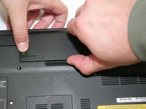

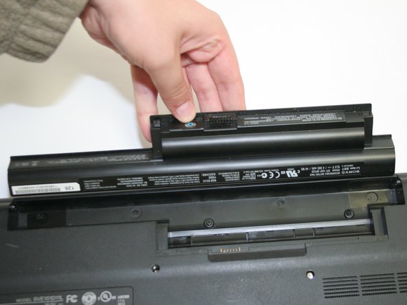

  8. Sony Vaio SVE15112FXS Fan Replacement: crwdns2935265:08crwdnd2935265:01crwdnd2935265:03crwdne2935265:0 Sony Vaio SVE15112FXS Fan Replacement: crwdns2935265:08crwdnd2935265:02crwdnd2935265:03crwdne2935265:0 Sony Vaio SVE15112FXS Fan Replacement: crwdns2935265:08crwdnd2935265:03crwdnd2935265:03crwdne2935265:0
    • Slide the "lock" tab upward to unlock the battery before removal.
    • While pushing the "release" tab upward, lift the battery and pull outward to remove it from the laptop.

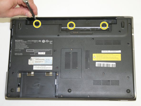

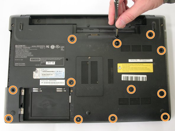

  9. Sony Vaio SVE15112FXS Fan Replacement: crwdns2935265:09crwdnd2935265:01crwdnd2935265:03crwdne2935265:0 Sony Vaio SVE15112FXS Fan Replacement: crwdns2935265:09crwdnd2935265:02crwdnd2935265:03crwdne2935265:0 Sony Vaio SVE15112FXS Fan Replacement: crwdns2935265:09crwdnd2935265:03crwdnd2935265:03crwdne2935265:0
    • To unsecure the bottom cover, remove all the cover screws using a #0 Phillips screwdriver.
    • Remove the two 9.0 mm screws on each side of the battery.
    • Remove the twelve 8.0 mm long screws alongside the entire back cover.
    • Remove the three 3.0 mm screws inside the battery well.

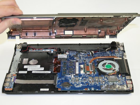

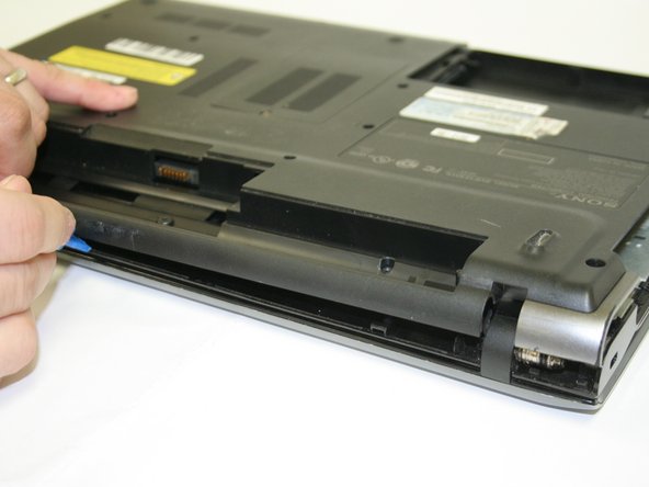

  10. Sony Vaio SVE15112FXS Fan Replacement: crwdns2935265:010crwdnd2935265:01crwdnd2935265:03crwdne2935265:0 Sony Vaio SVE15112FXS Fan Replacement: crwdns2935265:010crwdnd2935265:02crwdnd2935265:03crwdne2935265:0 Sony Vaio SVE15112FXS Fan Replacement: crwdns2935265:010crwdnd2935265:03crwdnd2935265:03crwdne2935265:0
    • Use a plastic opening tool to carefully pry open the latch points located under the silver plastic trim. Repeat this around the back cover.
    • It may be easiest to start around the CD-ROM bay because there is more room.
    • To avoid damaging the plastic trim and cover, do not force difficult areas and make sure the opening tool is completely under the black plastic cover, not just the silver trim.
    • Lift the back cover upward and away from the laptop.

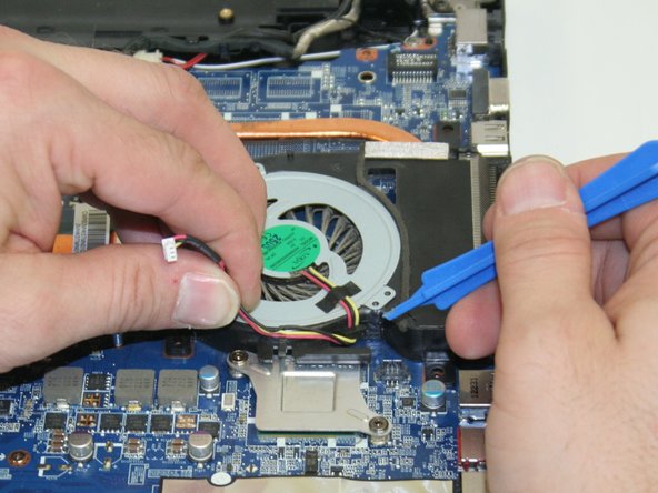

  11. Sony Vaio SVE15112FXS Fan Replacement: crwdns2935265:011crwdnd2935265:01crwdnd2935265:01crwdne2935265:0
    • Use a Phillips #00 screwdriver to remove the three 3.0 mm screws attaching the fan to the heat sink unit.
  12. Sony Vaio SVE15112FXS Fan Replacement: crwdns2935265:012crwdnd2935265:01crwdnd2935265:02crwdne2935265:0 Sony Vaio SVE15112FXS Fan Replacement: crwdns2935265:012crwdnd2935265:02crwdnd2935265:02crwdne2935265:0
    • Use a plastic opening tool to unsecure the white power cable connector.
    • Do not pull on the wires as this could rip them from the cable connector.
    • Carefully unwrap the red and yellow wires from the hooks.
    • Take note of how the wires are wrapped around the hooks.
  13. Sony Vaio SVE15112FXS Fan Replacement: crwdns2935265:013crwdnd2935265:01crwdnd2935265:01crwdne2935265:0
    • Lift the fan upward to remove it from the heat sink unit.
