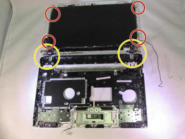

    1. Sony Vaio SVE111B11L  Screen Replacement, Screen: crwdns2935265:012crwdnd2935265:01crwdnd2935265:02crwdne2935265:0 Sony Vaio SVE111B11L  Screen Replacement, Screen: crwdns2935265:012crwdnd2935265:02crwdnd2935265:02crwdne2935265:0
      • Remove charging adaptor and battery. Some charge may still be in the battery or computer.
      • DO NOT touch connectors or copper yellow connector.
      • Locate screws. L 3.35mm X D 1.8mm
      • Remove Screws.
      • Lay the screen on a hard flat surface.
      • Remove hinges and wires for ease of removal.

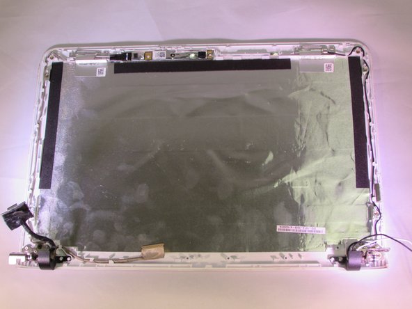

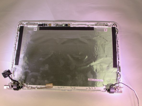

    2. Sony Vaio SVE111B11L  Screen Replacement: crwdns2935265:013crwdnd2935265:01crwdnd2935265:01crwdne2935265:0
      • Gently remove the screen cover.
      • Be careful of the camera at the top of the screen.
      • Be careful of the seal tape between the cover and the screen.

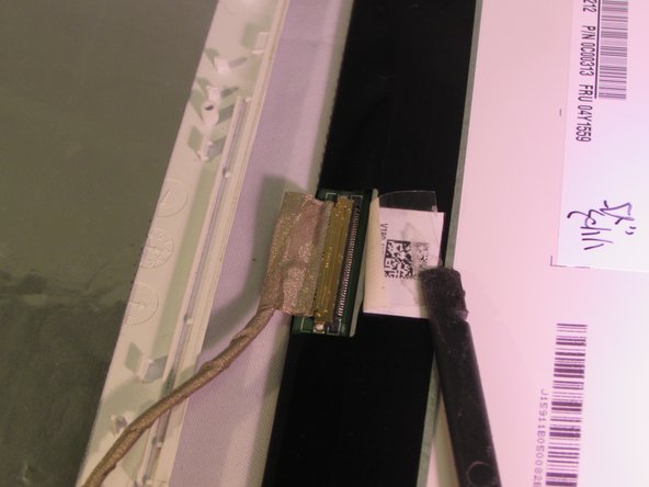

    3. Sony Vaio SVE111B11L  Screen Replacement: crwdns2935265:014crwdnd2935265:01crwdnd2935265:03crwdne2935265:0 Sony Vaio SVE111B11L  Screen Replacement: crwdns2935265:014crwdnd2935265:02crwdnd2935265:03crwdne2935265:0 Sony Vaio SVE111B11L  Screen Replacement: crwdns2935265:014crwdnd2935265:03crwdnd2935265:03crwdne2935265:0
      • Locate the wires and connectors.
      • Unplug the wires from the connectors.
      • Be careful of the yellow tape around the connection.
