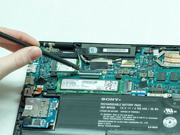

  4. Sony Vaio Pro 13 WiFi Card Replacement, WiFi Card: crwdns2935265:04crwdnd2935265:01crwdnd2935265:03crwdne2935265:0 Sony Vaio Pro 13 WiFi Card Replacement, WiFi Card: crwdns2935265:04crwdnd2935265:02crwdnd2935265:03crwdne2935265:0 Sony Vaio Pro 13 WiFi Card Replacement, WiFi Card: crwdns2935265:04crwdnd2935265:03crwdnd2935265:03crwdne2935265:0
    • Remove the black tape from on top of the WiFi card.
    • Use the spudger to remove the white wire from the WiFi card.

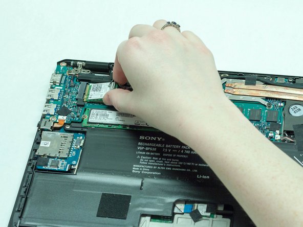

  5. Sony Vaio Pro 13 WiFi Card Replacement: crwdns2935265:05crwdnd2935265:01crwdnd2935265:02crwdne2935265:0 Sony Vaio Pro 13 WiFi Card Replacement: crwdns2935265:05crwdnd2935265:02crwdnd2935265:02crwdne2935265:0
    • Remove the 4.2mm Philips #00 screw located at the top of the battery.
    • Simply lift the WiFi card away from the computer.
