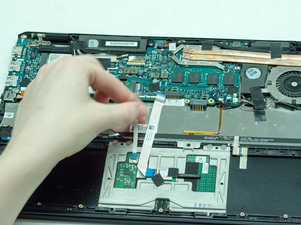

    1. Sony Vaio Pro 13 Trackpad Replacement, Trackpad: crwdns2935265:06crwdnd2935265:01crwdnd2935265:02crwdne2935265:0 Sony Vaio Pro 13 Trackpad Replacement, Trackpad: crwdns2935265:06crwdnd2935265:02crwdnd2935265:02crwdne2935265:0
      • Use the nylon spudger to lift up on both of the white wire strips.
      • Then use your fingers to lift them up.
    2. Sony Vaio Pro 13 Trackpad Replacement: crwdns2935265:07crwdnd2935265:01crwdnd2935265:02crwdne2935265:0 Sony Vaio Pro 13 Trackpad Replacement: crwdns2935265:07crwdnd2935265:02crwdnd2935265:02crwdne2935265:0
      • Using the Phillips head screwdriver, remove the four screws holding the track pad in.
      • Use the Phillips head again and remove the final black screw.
    3. Sony Vaio Pro 13 Trackpad Replacement: crwdns2935265:08crwdnd2935265:01crwdnd2935265:02crwdne2935265:0 Sony Vaio Pro 13 Trackpad Replacement: crwdns2935265:08crwdnd2935265:02crwdnd2935265:02crwdne2935265:0
      • Finally, remove the track pad from the computer.

I still have my old Sony Vaio pro, the track pad has been sticky recently and I've used this guide to take it apart and clean it. Very very helpful!! Happy to put off buying a new laptop for a bit longer, thank you :)
