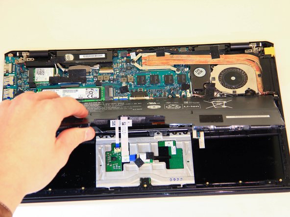

    • Gently lift the small, black piece of tape located near the fan.
  5. Sony Vaio Pro 13 Memory Card Reader/Writer Replacement: crwdns2935265:05crwdnd2935265:01crwdnd2935265:02crwdne2935265:0 Sony Vaio Pro 13 Memory Card Reader/Writer Replacement: crwdns2935265:05crwdnd2935265:02crwdnd2935265:02crwdne2935265:0
    • Remove the three 4.2mm Philips #0 screws located at the top of the battery.
    • Simply lift the battery away from the computer.

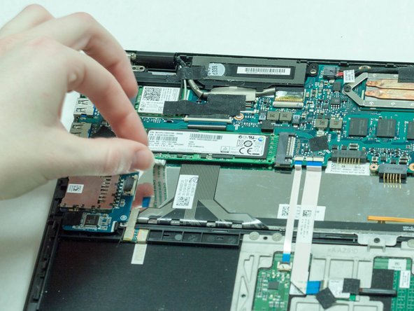

    • Using the flat end of the spudger, pry the edge of the ribbon wire on top of the memory card so it is loose enough to detach from the memory card.

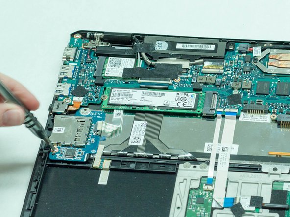

    • Lift up the small, square, black piece of tape that covers the screw on the memory card.
    • Using the philips head 00, unscrew the screw holding the memory card in place.
    • Once the screw is out, the memory card should lift up easily.
