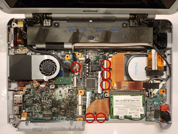

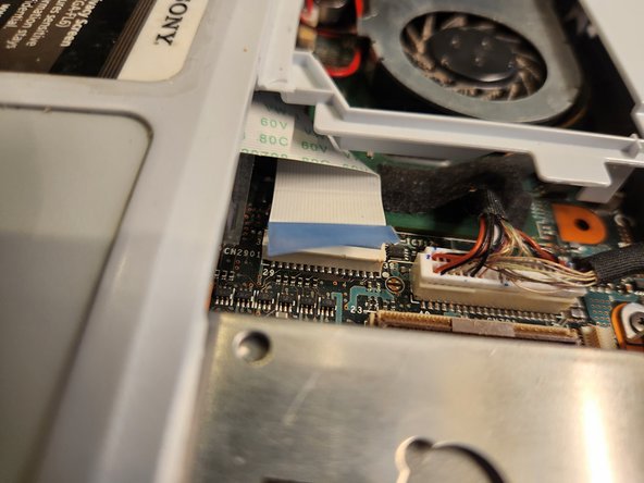

  8. Sony Vaio PCG-TR3A Teardown, Removing The Motherboard: crwdns2935265:08crwdnd2935265:01crwdnd2935265:03crwdne2935265:0 Sony Vaio PCG-TR3A Teardown, Removing The Motherboard: crwdns2935265:08crwdnd2935265:02crwdnd2935265:03crwdne2935265:0 Sony Vaio PCG-TR3A Teardown, Removing The Motherboard: crwdns2935265:08crwdnd2935265:03crwdnd2935265:03crwdne2935265:0
    • Remove the three screws holding the board in place.
    • Disconnect the ribbon cables connecting the daughterboards to the motherboard and the large connector in the middle of the board.
    • Lift up the board gently. There will be two connectors on the underside of the board. Disconnect them before completely removing the board.
