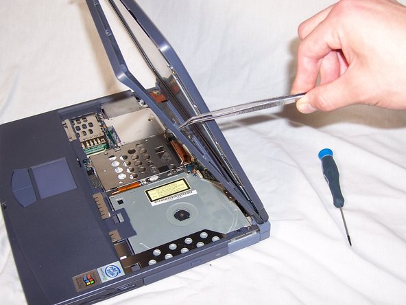

  10. Sony Vaio PCG-F420 Display Replacement, Display: crwdns2935265:010crwdnd2935265:01crwdnd2935265:01crwdne2935265:0
    • Use tweezers to remove the rubber covers on the four screws at the corners near the display.
  11. Sony Vaio PCG-F420 Display Replacement: crwdns2935265:011crwdnd2935265:01crwdnd2935265:01crwdne2935265:0
    • With the screwdriver, unscrew the four screws that attached the front bezel panel with the display assembly, as shown in the image.
  12. Sony Vaio PCG-F420 Display Replacement: crwdns2935265:012crwdnd2935265:01crwdnd2935265:01crwdne2935265:0
    • Using a spudger or another flat-headed tool, pry away the front bezel panel from the display assembly.
    • Apply pressure carefully while placing the spudger on the seam connecting the front and rear bezels.
    • Clips attaching the two panels should start to come apart.
  13. Sony Vaio PCG-F420 Display Replacement: crwdns2935265:013crwdnd2935265:01crwdnd2935265:03crwdne2935265:0 Sony Vaio PCG-F420 Display Replacement: crwdns2935265:013crwdnd2935265:02crwdnd2935265:03crwdne2935265:0 Sony Vaio PCG-F420 Display Replacement: crwdns2935265:013crwdnd2935265:03crwdnd2935265:03crwdne2935265:0
    • There are a total of 14 clips holding the two bezel panels together. Be careful when unclipping all of them.After all the clips are off, the bezel will just pop right off the display panel.
    • Remove all 14 clips and place them in a safe area.
    • Once all 14 clips are removed the bezel can be removed.

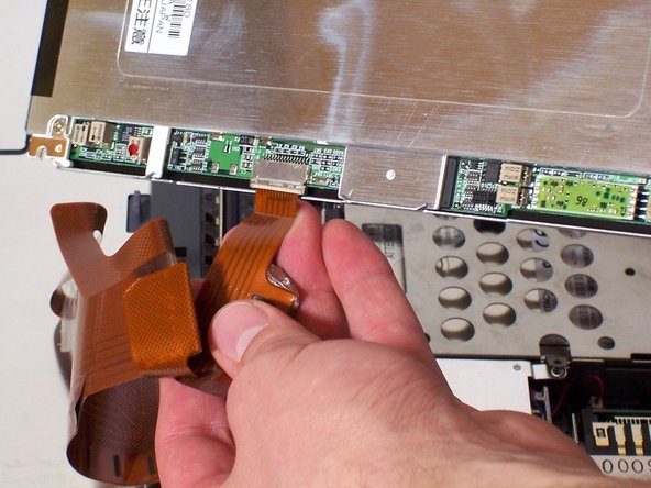

  15. Sony Vaio PCG-F420 Display Replacement: crwdns2935265:015crwdnd2935265:01crwdnd2935265:02crwdne2935265:0 Sony Vaio PCG-F420 Display Replacement: crwdns2935265:015crwdnd2935265:02crwdnd2935265:02crwdne2935265:0
    • Locate the ribbon cable slot and the two-pin backlight cable. These are essential connections for the display.
    • Gently, but firmly, grasp the ribbon cable near its connection point.
    • Use steady, even pressure to pull the ribbon cable out of its socket. Be careful not to use excessive force.
    • Similarly, disconnect the two-pin backlight cable with gentle and controlled force. Ensure you disconnect both cables securely to avoid any damage during removal.
