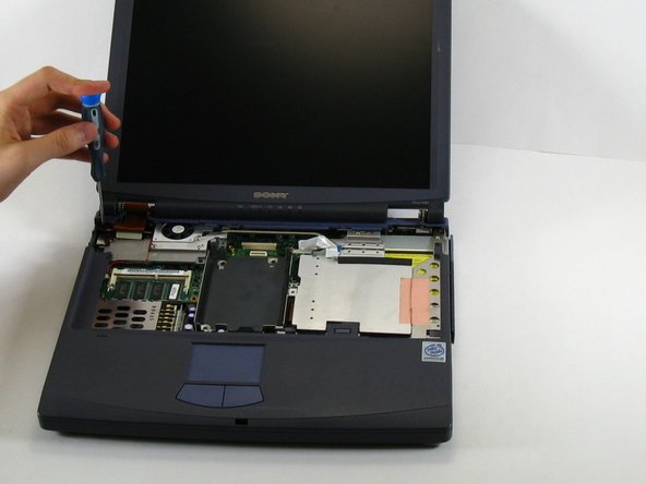

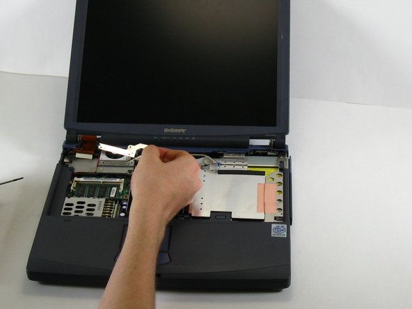

    • Remove the three screws surrounding the fan.
    • Take off the guard that you just unscrewed.
    • Carefully flip over the heat pipe and the metal sheet connected to it.

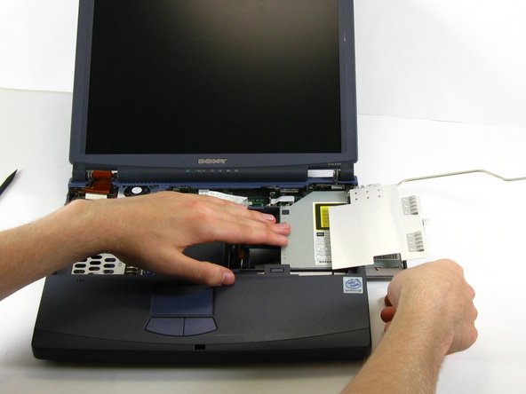

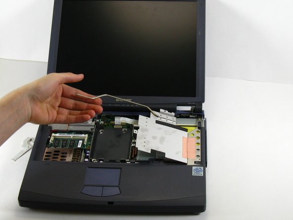

    • Remove the three screws from the heat tube cover.
    • Carefully remove the cover.
  10. Sony Vaio PCG-F360 Optical Drive Replacement: crwdns2935265:010crwdnd2935265:01crwdnd2935265:02crwdne2935265:0 Sony Vaio PCG-F360 Optical Drive Replacement: crwdns2935265:010crwdnd2935265:02crwdnd2935265:02crwdne2935265:0
    • Use a spudger to pry the ribbon connected to the optical drive.
    • Slide the optical drive free of the enclosure.
