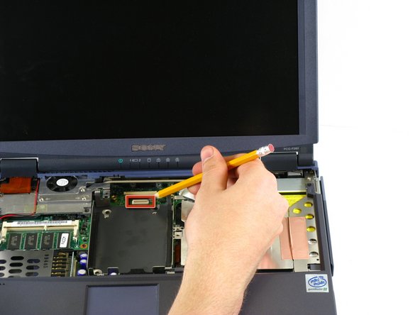

  8. Sony Vaio PCG-F360 Hard Drive Replacement, Hard Drive: crwdns2935265:08crwdnd2935265:01crwdnd2935265:02crwdne2935265:0 Sony Vaio PCG-F360 Hard Drive Replacement, Hard Drive: crwdns2935265:08crwdnd2935265:02crwdnd2935265:02crwdne2935265:0
    • We had a bit of a surprise when we opened our Sony. The hard drive was missing! While this is common practice when disposing of or selling a computer, it means that we're unable to show you what the hard drive looks inside the laptop.
    • If a hard drive was present, it would attach to the motherboard by the shown connector.
