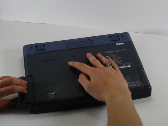

    1. Sony Vaio PCG-F360 Floppy Drive Replacement, Floppy Drive: crwdns2935265:05crwdnd2935265:01crwdnd2935265:02crwdne2935265:0 Sony Vaio PCG-F360 Floppy Drive Replacement, Floppy Drive: crwdns2935265:05crwdnd2935265:02crwdnd2935265:02crwdne2935265:0
      • With one hand slide and hold the tab shown.
      • With your other hand, pull the floppy drive out of the floppy drive bay.
      • To replace the floppy drive, simply slide the drive into the slot until it clicks.
