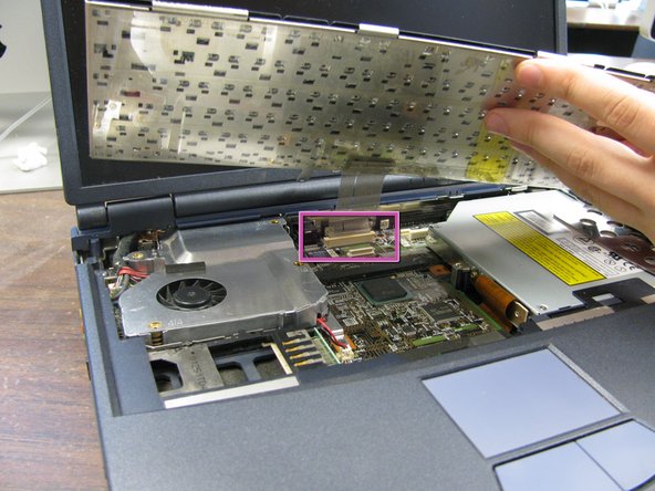

  3. Sony Vaio PCG-981L Fan Replacement or Cleaning: crwdns2935265:03crwdnd2935265:01crwdnd2935265:03crwdne2935265:0 Sony Vaio PCG-981L Fan Replacement or Cleaning: crwdns2935265:03crwdnd2935265:02crwdnd2935265:03crwdne2935265:0 Sony Vaio PCG-981L Fan Replacement or Cleaning: crwdns2935265:03crwdnd2935265:03crwdnd2935265:03crwdne2935265:0
    • To remove the keyboard, lift it a few inches from the computer, taking care not to pull beyond the length of the ribbon cable that secures it to the motherboard.
    • Forcefully removing the ribbon cable can cause irreversible damage.
    • Separate the ribbon cable from the motherboard by placing your fingers at the base and pulling gently.
  4. Sony Vaio PCG-981L Fan Replacement or Cleaning: crwdns2935265:04crwdnd2935265:01crwdnd2935265:03crwdne2935265:0 Sony Vaio PCG-981L Fan Replacement or Cleaning: crwdns2935265:04crwdnd2935265:02crwdnd2935265:03crwdne2935265:0 Sony Vaio PCG-981L Fan Replacement or Cleaning: crwdns2935265:04crwdnd2935265:03crwdnd2935265:03crwdne2935265:0
    • Attach the new keyboard’s ribbon cable to the motherboard by carefully inserting it into the white plastic outlet located at the top center of the motherboard.
    • Set the keyboard in place.
