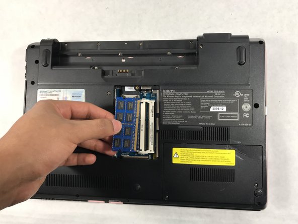

  3. Sony Vaio PCG-61411L RAM Replacement, RAM: crwdns2935265:03crwdnd2935265:01crwdnd2935265:01crwdne2935265:0
    • The RAM cards reside in the rectangle shaped plate in the center of the back panel of the device.

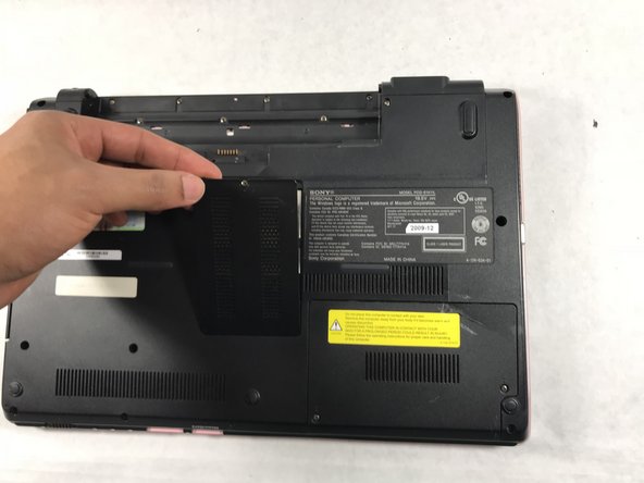

  4. Sony Vaio PCG-61411L RAM Replacement: crwdns2935265:04crwdnd2935265:01crwdnd2935265:02crwdne2935265:0 Sony Vaio PCG-61411L RAM Replacement: crwdns2935265:04crwdnd2935265:02crwdnd2935265:02crwdne2935265:0
    • Unscrew the single PH1 6mm screw at the top of the panel. The screw remains in the panel.
    • Remove the panel by lifting it towards yourself.

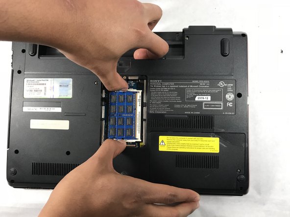

    • To remove the individual RAM card panels, snap back the metal latches on each side of the cards.
  6. Sony Vaio PCG-61411L RAM Replacement: crwdns2935265:06crwdnd2935265:01crwdnd2935265:02crwdne2935265:0 Sony Vaio PCG-61411L RAM Replacement: crwdns2935265:06crwdnd2935265:02crwdnd2935265:02crwdne2935265:0
    • After pinching the metal latches, the RAM card should pop out slightly upward.
    • Remove the cards by pulling them out to the left.
    • Repeat for the second panel of RAM cards.
