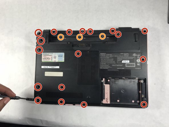

    • Be sure to disconnect the device charger and power down the device before beginning.
    • Turn the device over onto its back, where the battery is at the top of the device. Slide the "lock" switch to the right.
  2. Sony Vaio PCG-61411L Keyboard Replacement: crwdns2935265:02crwdnd2935265:01crwdnd2935265:03crwdne2935265:0 Sony Vaio PCG-61411L Keyboard Replacement: crwdns2935265:02crwdnd2935265:02crwdnd2935265:03crwdne2935265:0 Sony Vaio PCG-61411L Keyboard Replacement: crwdns2935265:02crwdnd2935265:03crwdnd2935265:03crwdne2935265:0
    • Slide the "release" switch to the left and gently lift the battery up to remove it.
    • Completely remove the battery from the device.

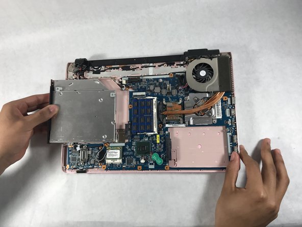

  7. Sony Vaio PCG-61411L Keyboard Replacement, Optical Disc Drive: crwdns2935265:07crwdnd2935265:01crwdnd2935265:02crwdne2935265:0 Sony Vaio PCG-61411L Keyboard Replacement, Optical Disc Drive: crwdns2935265:07crwdnd2935265:02crwdnd2935265:02crwdne2935265:0
    • Remove the 5mm screws with the PH0 screwdriver.
    • Remove the 3mm screws with the PH0 screwdriver.

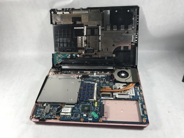

  8. Sony Vaio PCG-61411L Keyboard Replacement: crwdns2935265:08crwdnd2935265:01crwdnd2935265:02crwdne2935265:0 Sony Vaio PCG-61411L Keyboard Replacement: crwdns2935265:08crwdnd2935265:02crwdnd2935265:02crwdne2935265:0
    • Lift the backplate from bottom right and left corner and remove it from the laptop.
  9. Sony Vaio PCG-61411L Keyboard Replacement: crwdns2935265:09crwdnd2935265:01crwdnd2935265:02crwdne2935265:0 Sony Vaio PCG-61411L Keyboard Replacement: crwdns2935265:09crwdnd2935265:02crwdnd2935265:02crwdne2935265:0
    • Slide your finger from the right of the optical disc and pull the optical disc from right to left.

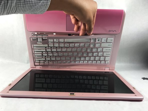

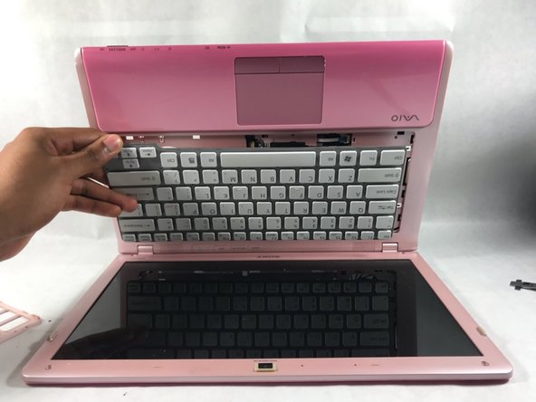

  10. Sony Vaio PCG-61411L Keyboard Replacement, Keyboard: crwdns2935265:010crwdnd2935265:01crwdnd2935265:02crwdne2935265:0 Sony Vaio PCG-61411L Keyboard Replacement, Keyboard: crwdns2935265:010crwdnd2935265:02crwdnd2935265:02crwdne2935265:0
    • Push keyboard out from the hole located in the optical drives original location.
  11. Sony Vaio PCG-61411L Keyboard Replacement: crwdns2935265:011crwdnd2935265:01crwdnd2935265:03crwdne2935265:0 Sony Vaio PCG-61411L Keyboard Replacement: crwdns2935265:011crwdnd2935265:02crwdnd2935265:03crwdne2935265:0 Sony Vaio PCG-61411L Keyboard Replacement: crwdns2935265:011crwdnd2935265:03crwdnd2935265:03crwdne2935265:0
    • Remove the keyboard cover by gently pulling along the sides until it is removed completely.

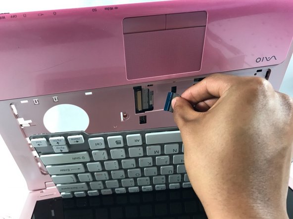

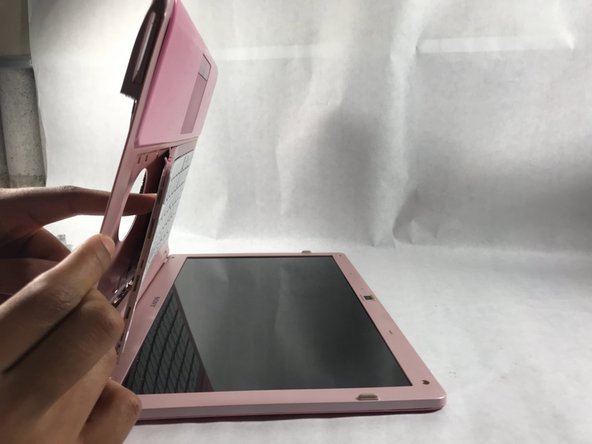

  12. Sony Vaio PCG-61411L Keyboard Replacement: crwdns2935265:012crwdnd2935265:01crwdnd2935265:02crwdne2935265:0 Sony Vaio PCG-61411L Keyboard Replacement: crwdns2935265:012crwdnd2935265:02crwdnd2935265:02crwdne2935265:0
    • Disconnect the keyboard by pulling the connection wire in the opposite direction of where it's connected.
