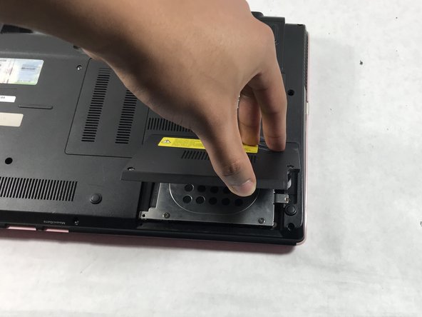

  4. Sony Vaio PCG-61411L Hard Drive Replacement: crwdns2935265:04crwdnd2935265:01crwdnd2935265:02crwdne2935265:0 Sony Vaio PCG-61411L Hard Drive Replacement: crwdns2935265:04crwdnd2935265:02crwdnd2935265:02crwdne2935265:0
    • Using the PH #0 screwdriver, unscrew the two 6.5mm screws located in the bottom left and middle right of the panel. The screws remain in the panels.
    • Remove the panel by pulling it up towards yourself.

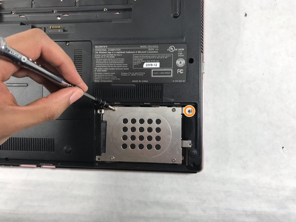

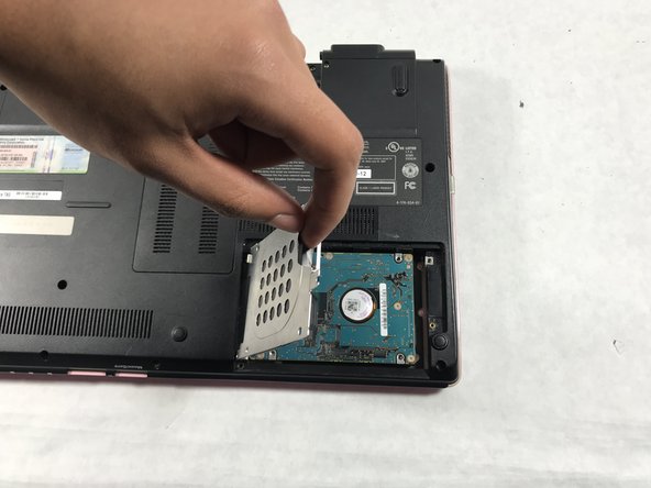

  5. Sony Vaio PCG-61411L Hard Drive Replacement: crwdns2935265:05crwdnd2935265:01crwdnd2935265:03crwdne2935265:0 Sony Vaio PCG-61411L Hard Drive Replacement: crwdns2935265:05crwdnd2935265:02crwdnd2935265:03crwdne2935265:0 Sony Vaio PCG-61411L Hard Drive Replacement: crwdns2935265:05crwdnd2935265:03crwdnd2935265:03crwdne2935265:0
    • Using a PH0 screwdriver, remove the four 3mm silver screws located in the external hard drive cover.
    • Using a PH00 screwdriver, remove the final 3mm black screw located in the top right section of the hard drive cover.
    • Carefully remove the silver hard drive cover.

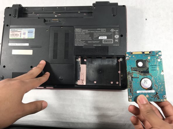

  6. Sony Vaio PCG-61411L Hard Drive Replacement: crwdns2935265:06crwdnd2935265:01crwdnd2935265:03crwdne2935265:0 Sony Vaio PCG-61411L Hard Drive Replacement: crwdns2935265:06crwdnd2935265:02crwdnd2935265:03crwdne2935265:0 Sony Vaio PCG-61411L Hard Drive Replacement: crwdns2935265:06crwdnd2935265:03crwdnd2935265:03crwdne2935265:0
    • Detach the hard drive by disconnecting it from the motherboard, pulling it gently from left to right.
