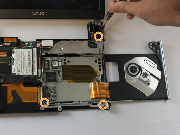

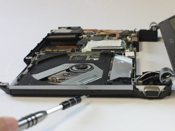

  14. Sony Vaio PCG-4G1L Optical Drive Replacement, Optical Drive: crwdns2935265:014crwdnd2935265:01crwdnd2935265:02crwdne2935265:0 Sony Vaio PCG-4G1L Optical Drive Replacement, Optical Drive: crwdns2935265:014crwdnd2935265:02crwdnd2935265:02crwdne2935265:0
    • Insert the PH0.8 bit into the pin hole to eject the optical drive.
  15. Sony Vaio PCG-4G1L Optical Drive Replacement: crwdns2935265:015crwdnd2935265:01crwdnd2935265:02crwdne2935265:0 Sony Vaio PCG-4G1L Optical Drive Replacement: crwdns2935265:015crwdnd2935265:02crwdnd2935265:02crwdne2935265:0
    • Remove one 4mm Phillips #0 pan head screw, using a Bit Driver with a Phillips PH000 bit.
    • Remove three 5mm Phillips #0 flat head screws, using a Bit Driver with a Phillips PH000 bit.

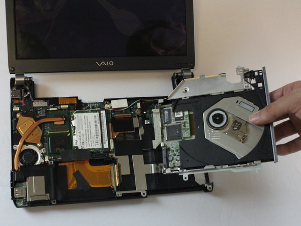

  16. Sony Vaio PCG-4G1L Optical Drive Replacement: crwdns2935265:016crwdnd2935265:01crwdnd2935265:02crwdne2935265:0 Sony Vaio PCG-4G1L Optical Drive Replacement: crwdns2935265:016crwdnd2935265:02crwdnd2935265:02crwdne2935265:0
    • Apply pressure to the ribbon cable, then pick up and pull the optical drive away from the cable.
