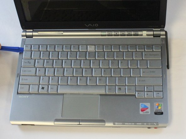

  5. Sony Vaio PCG-4G1L Hard Drive  Replacement: crwdns2935265:05crwdnd2935265:01crwdnd2935265:02crwdne2935265:0 Sony Vaio PCG-4G1L Hard Drive  Replacement: crwdns2935265:05crwdnd2935265:02crwdnd2935265:02crwdne2935265:0
    • Be sure to pry the plastic opening tool under the keyboard, rather than under the keys. Otherwise, some keys could get harmed.
    • While using a plastic opening tool, carefully lift the keyboard by inserting the tool under the edge.

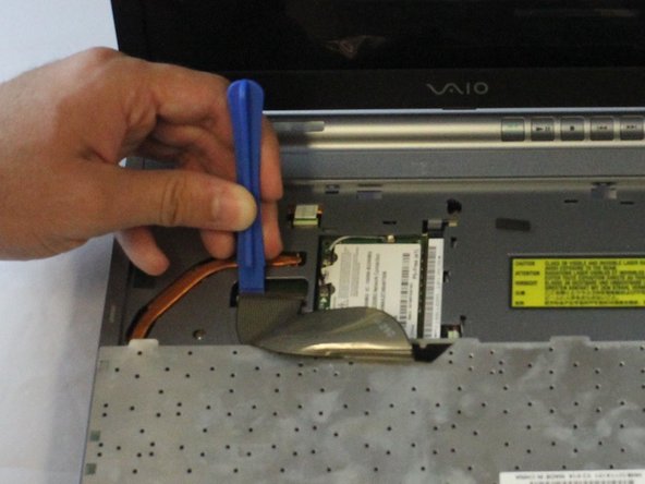

  6. Sony Vaio PCG-4G1L Hard Drive  Replacement: crwdns2935265:06crwdnd2935265:01crwdnd2935265:03crwdne2935265:0 Sony Vaio PCG-4G1L Hard Drive  Replacement: crwdns2935265:06crwdnd2935265:02crwdnd2935265:03crwdne2935265:0 Sony Vaio PCG-4G1L Hard Drive  Replacement: crwdns2935265:06crwdnd2935265:03crwdnd2935265:03crwdne2935265:0
    • Do not pull the keyboard too far away, as a ribbon cable is still attached. Failing to do so can cause damage to the ribbon cable or the connector.
    • Use the plastic opening tool to release the clamp.
    • Using slight pressure, remove the ribbon cable with your fingers.

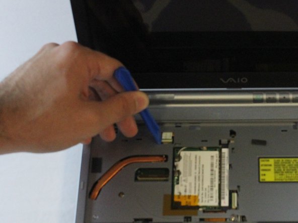

  7. Sony Vaio PCG-4G1L Hard Drive  Replacement, Network Antenna: crwdns2935265:07crwdnd2935265:01crwdnd2935265:01crwdne2935265:0
    • Swivel the Network Antenna up so that it points upward.
  8. Sony Vaio PCG-4G1L Hard Drive  Replacement: crwdns2935265:08crwdnd2935265:01crwdnd2935265:02crwdne2935265:0 Sony Vaio PCG-4G1L Hard Drive  Replacement: crwdns2935265:08crwdnd2935265:02crwdnd2935265:02crwdne2935265:0
    • Pinch thumb and index finger at the Network Antenna's base.
    • Make sure not to bend the Network Antenna. Failing to do so can cause damage to the antenna.
    • Pull the Network Antenna off.

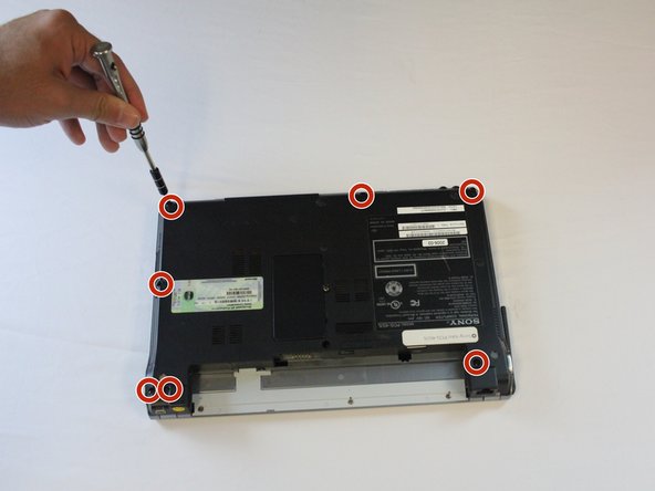

  9. Sony Vaio PCG-4G1L Hard Drive  Replacement, Plastic Casing: crwdns2935265:09crwdnd2935265:01crwdnd2935265:02crwdne2935265:0 Sony Vaio PCG-4G1L Hard Drive  Replacement, Plastic Casing: crwdns2935265:09crwdnd2935265:02crwdnd2935265:02crwdne2935265:0
    • Remove seven 5 mm Phillips #1 pan head screws with a Bit Driver, using a Phillips PH1 bit.
  10. Sony Vaio PCG-4G1L Hard Drive  Replacement: crwdns2935265:010crwdnd2935265:01crwdnd2935265:02crwdne2935265:0 Sony Vaio PCG-4G1L Hard Drive  Replacement: crwdns2935265:010crwdnd2935265:02crwdnd2935265:02crwdne2935265:0
    • Remove one 7 mm Phillips #1 Pan Head Screw by using a Bit Driver with Phillips PH1 bit.
