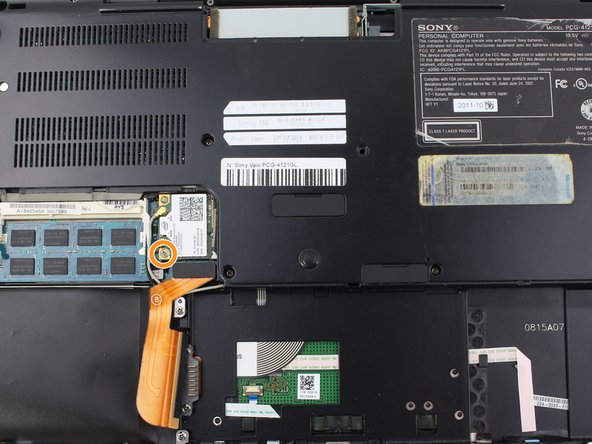

    • Remove the two 3mm Phillips #0 screws on the bottom of the computer that secure the plastic backing.
  2. Sony Vaio PCG-4121GL Wifi Board Replacement: crwdns2935265:02crwdnd2935265:01crwdnd2935265:03crwdne2935265:0 Sony Vaio PCG-4121GL Wifi Board Replacement: crwdns2935265:02crwdnd2935265:02crwdnd2935265:03crwdne2935265:0 Sony Vaio PCG-4121GL Wifi Board Replacement: crwdns2935265:02crwdnd2935265:03crwdnd2935265:03crwdne2935265:0
    • Pull the bottom plate towards yourself until it unhinges fully.
    • Once the plate is free from the backing remove it completely.

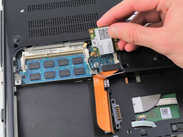

  5. Sony Vaio PCG-4121GL Wifi Board Replacement, WiFi Board: crwdns2935265:05crwdnd2935265:01crwdnd2935265:02crwdne2935265:0 Sony Vaio PCG-4121GL Wifi Board Replacement, WiFi Board: crwdns2935265:05crwdnd2935265:02crwdnd2935265:02crwdne2935265:0
    • Lift up the two golden knobs on the left side of the WiFi board.
    • Remove the single 3mm Phillips #0 screw located on the WiFi board to the top left of the battery compartment.
  6. Sony Vaio PCG-4121GL Wifi Board Replacement: crwdns2935265:06crwdnd2935265:01crwdnd2935265:02crwdne2935265:0 Sony Vaio PCG-4121GL Wifi Board Replacement: crwdns2935265:06crwdnd2935265:02crwdnd2935265:02crwdne2935265:0
    • Once the screw and the golden knobs have been disconnected, pull the WiFi board out to the left.
    • Once the WiFi board is free from the device, remove completely.
