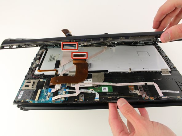

  8. Sony Vaio PCG-4121GL SD Card Board Replacement: crwdns2935265:08crwdnd2935265:01crwdnd2935265:02crwdne2935265:0 Sony Vaio PCG-4121GL SD Card Board Replacement: crwdns2935265:08crwdnd2935265:02crwdnd2935265:02crwdne2935265:0
    • Gently pull apart the top and bottom plastic bodies.
    • Carefully remove the cable connectors.
    • Slowly detach bottom component to avoid tearing wires/connectors.

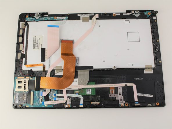

  9. Sony Vaio PCG-4121GL SD Card Board Replacement: crwdns2935265:09crwdnd2935265:01crwdnd2935265:03crwdne2935265:0 Sony Vaio PCG-4121GL SD Card Board Replacement: crwdns2935265:09crwdnd2935265:02crwdnd2935265:03crwdne2935265:0 Sony Vaio PCG-4121GL SD Card Board Replacement: crwdns2935265:09crwdnd2935265:03crwdnd2935265:03crwdne2935265:0
    • Pull apart your device and set aside the screen of your laptop.

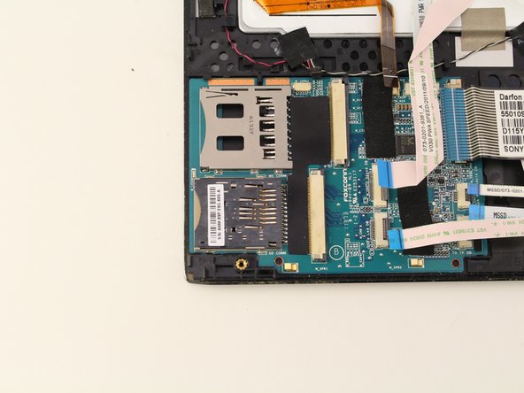

    • Locate the SD Card Board in the bottom left of the computer body.

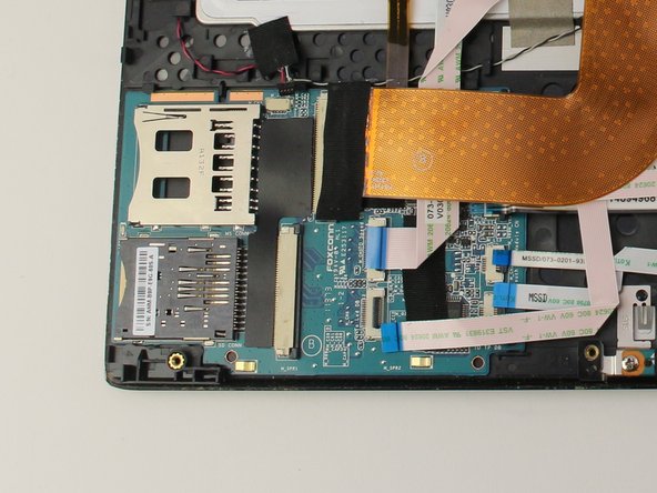

  10. Sony Vaio PCG-4121GL SD Card Board Replacement: crwdns2935265:010crwdnd2935265:01crwdnd2935265:02crwdne2935265:0 Sony Vaio PCG-4121GL SD Card Board Replacement: crwdns2935265:010crwdnd2935265:02crwdnd2935265:02crwdne2935265:0
    • Remove the cables from their connectors.
    • Do not apply too much force to the cable connectors or they may tear.
  11. Sony Vaio PCG-4121GL SD Card Board Replacement: crwdns2935265:011crwdnd2935265:01crwdnd2935265:02crwdne2935265:0 Sony Vaio PCG-4121GL SD Card Board Replacement: crwdns2935265:011crwdnd2935265:02crwdnd2935265:02crwdne2935265:0
    • Lightly press down on the bottom left corner of the plastic frame.
    • Pull SD Board out towards you once it feels loose.
    • Once the SD Board is free from the plastic, remove completely
    • The SD Card slot is shown.
