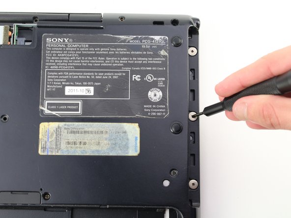

    • Remove the two 3mm Phillips #0 screws on the bottom of the computer that secure the plastic backing.
  2. Sony Vaio PCG-4121GL Keyboard Replacement: crwdns2935265:02crwdnd2935265:01crwdnd2935265:03crwdne2935265:0 Sony Vaio PCG-4121GL Keyboard Replacement: crwdns2935265:02crwdnd2935265:02crwdnd2935265:03crwdne2935265:0 Sony Vaio PCG-4121GL Keyboard Replacement: crwdns2935265:02crwdnd2935265:03crwdnd2935265:03crwdne2935265:0
    • Pull the bottom plate towards yourself until it unhinges fully.
    • Once the plate is free from the backing remove it completely.

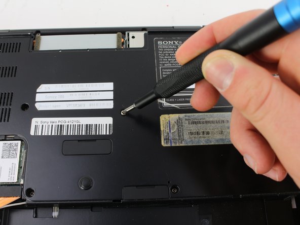

    • Remove seven 3mm Phillips #0 screws from the bottom of the computer.
    • Remove eight 5mm Phillips #0 screws.

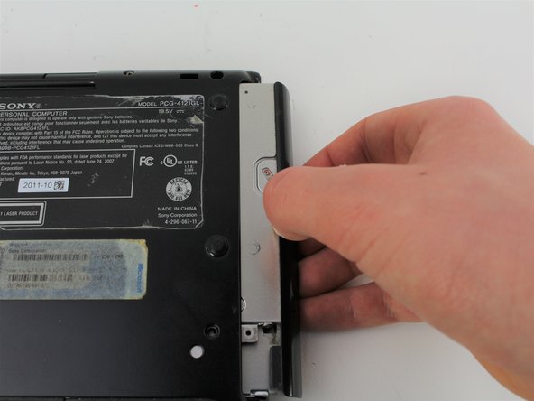

  6. Sony Vaio PCG-4121GL Keyboard Replacement: crwdns2935265:06crwdnd2935265:01crwdnd2935265:03crwdne2935265:0 Sony Vaio PCG-4121GL Keyboard Replacement: crwdns2935265:06crwdnd2935265:02crwdnd2935265:03crwdne2935265:0 Sony Vaio PCG-4121GL Keyboard Replacement: crwdns2935265:06crwdnd2935265:03crwdnd2935265:03crwdne2935265:0

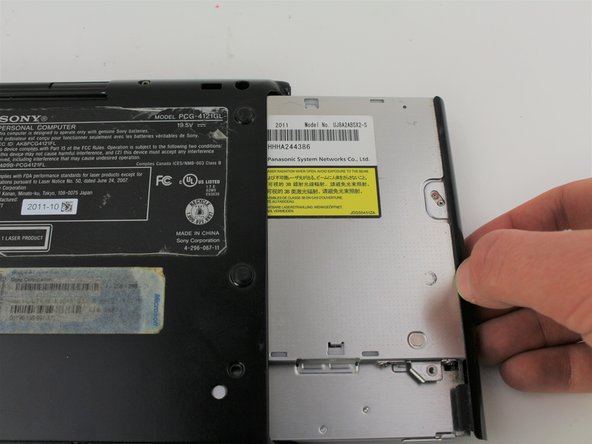

    • Carefully remove the disk drive from its compartment.

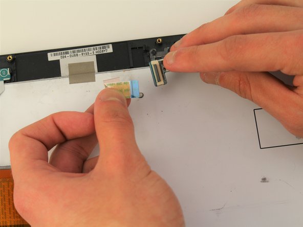

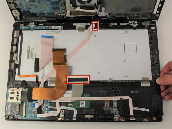

    • Gently pull apart the top and bottom plastic bodies.
    • Carefully lift up tabs to detach cable connectors.
    • Slowly detach bottom component to avoid tearing wires/connectors.

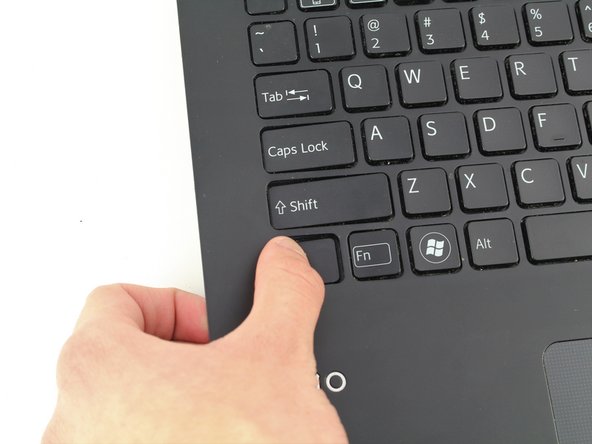

    • Remove the tape strips along the edge of the keyboard.
    • Once the keyboard is disconnected, slowly poke out keys one-by-one.
    • When the keyboard is free to move, remove it completely.
    • The keyboard is held in place with glue, once it is removed it is likely that it will not go back in the same way.
